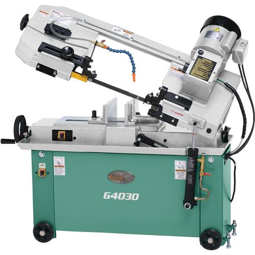

I bought a Chinese made saw from Grizzly many years ago and it worked extremely well, and I cut a LOT of metal with it, mostly at angles......
It sounds like the two wheels are not aligned properly but like the other poster said, the blade should not walk.
On mine, I found that the cut speed (drop speed as well as blade speed) made a lot of difference, if it dropped too fast it would bind or the blade would come off.... it took a bit of fiddling to find the right combination, but once there it worked a treat.
If you're cutting a lot of metal these things are fantastic, you can start a cut and walk away as it will shut itself off once the cut is thru, and I found that once set up the angle cuts were very accurate.
Mine was just like this, and I got it on sale and got free shipping, so my recollection was $600. it has several nice features, including the adjustable blade stabilizer, three speed gearbox, built in coolant pump, adjustable stop for repeated cuts...all in all I thought it was a quality saw.

I agree with post #17, those import 7x12's are fantastic. The Grizzly is probably overpriced (today). I got a killer deal and got mine for $500 but it was a fluke, one time deal. Cheapest I see them these days is $850 thru Enco. Try to get one with the vertical downfeed cylinder rather than angled. Blades for these are cheap at $25 each and last forever if cared for.
The key to any of these saws (4x6 or 7x12) is get the blade what you think is too tight... then it's maybe just tight enough.
I just cut a bunch of thick aluminum with my 7x12; put on a 4/6 blade and cranked the blade speed all the way up (step pulley). I could watch the bow flex in/out but it cut great and never threw the blade.
OP, the 7x12's are a HUGE step up and can easily be rolled against a wall, then rolled out when needed. This is what I do, it's like "retractable band saw." The integrated coolant pump alone and hydraulic cylinder for downfeed are two significant upgrades over the 4x6's.
