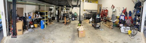

Sometimes I remember I have a lift and not just a race car parking pad. Definitely better than the ground. IMG_2912.jpeg
The four post does really well on suspension work and added bonus of easy diy alignments on it.

Been a minute. Race car season is in full effect but still not done 😅
Finally had a few favors traded in and got the mini split installed. The boys did an awesome job and left me room for the "future shed" on my gravel pad. Even just the fan on low circulates the air nicely. Can't wait to crank it on a 90deg day and see how it does.
Back to work wiring some pos volkswagens. Just in more comfort.
More organizing to do, but thats always.
