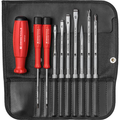

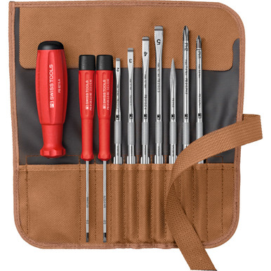

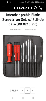

Does anyone own and actually use these PB Swiss screwdrivers with interchangeable blades?
Model #8215/#8218
If yes, what do you use them for? How strong are they? Would these hold up to automotive use (in a non-shop environment)?
