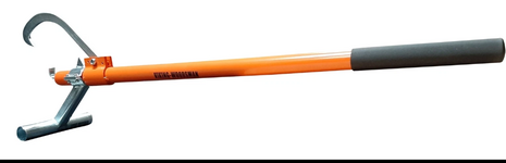

My neighbor and I share a Stihl 60" with the log lift attachment. It looks similar to this one. I have cranked on it and it has withstood the abuse.
Looks like a Cant Hook with a pivot point added to it.
A Peavy has a spike sticking out the end, the Cant Hook has no spike. I have not used a Timber Jack, but I imagine that is what is in the picture.
It will not only turn a log but can raise it enough to keep your saw chain away from the soil under a log that you want to cut.
Soil is very hard on chains, keep your chain clean and well lubricated.

If you are having a faller just drop them for you on the property, you want one of these:
OR the device that @LopezBart posted just above - either of them will do the job.
But you MUST get the wood up off the ground to buck it up, or you're going to jam the tip of the bar into the dirt and trash a perfectly good chain and possibly the bar (which can get really, really spendy.)
One of those tools, in combination with a 5-foot long "pinch-point bar" (aka "digging bar") will allow a good man to move entire trees around at will.
Buy at least four plastic wedges before you make the first cut.
Watch out for stuff that's in a bind. Be safe.
