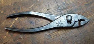

These WORTH pliers are in that catalog listing. The nickel plating has held up well. Especially compared to the bare steel pair. I suspect those were made by WORTH as well, but can no longer read the logo.

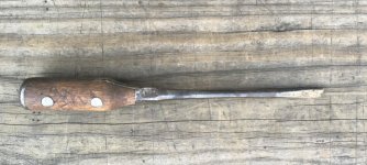

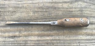

Here are some examples of Pexto style screwdrivers with the asterisk marking. The last two pictures are from an eBay listing.
-Don34507D31-9FB0-4635-94FD-5A957CCDD414.jpg0BAF6274-AE9D-4E64-8FF9-61984FCBA3DB.jpg6020E737-E73B-4D47-A9B2-8C43546A851B.jpg34ABAC21-0A7D-4261-AB41-6CC91084202B.jpeg1BEAC7E6-62C7-4CED-BB68-A00882606121.jpeg

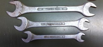

I do not believe that the small asterisk forging marks on Barcalo tools are indications that those tools were made by Pexto. Many Barcalo wrenches have a variety of forging marks and the asterisks were used on several styles and vintages of Barcalo wrenches.
-Don3F93AD09-6B73-42AB-9B0A-8377EECCF14D.jpg51ED37DC-34A0-46A6-8774-D0F0A45939B7.jpgBB764199-653F-4C80-81AD-FD7D92C8C47F.jpg3A33EA1F-81E9-4F74-9B4B-222FC11AE891.jpgCE774D3F-DCEA-49DE-8759-BF032DAF162F.jpeg

Here are a pair of Peck Stowe & Wilcox monkey wrenches I received as part of my Wednesday tool haul. The markings indicate manufacture before 1915 so the condition of the wooden handles is remarkable.
Shiftless
Mar 9, 2014
14,832
East Bay SFO
Don:
That was an amazing haul!
Nice pair of Coes pattern wrenches. (Is that what they’re called generically?)
I can’t imagine what you had to leave behind.
