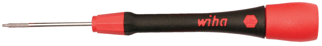

Wiha:
https://www.wihatools.com/products/precision-pentalobe-screwdrivers
PL1, PL2, PL3, PL4, PL5, PL6

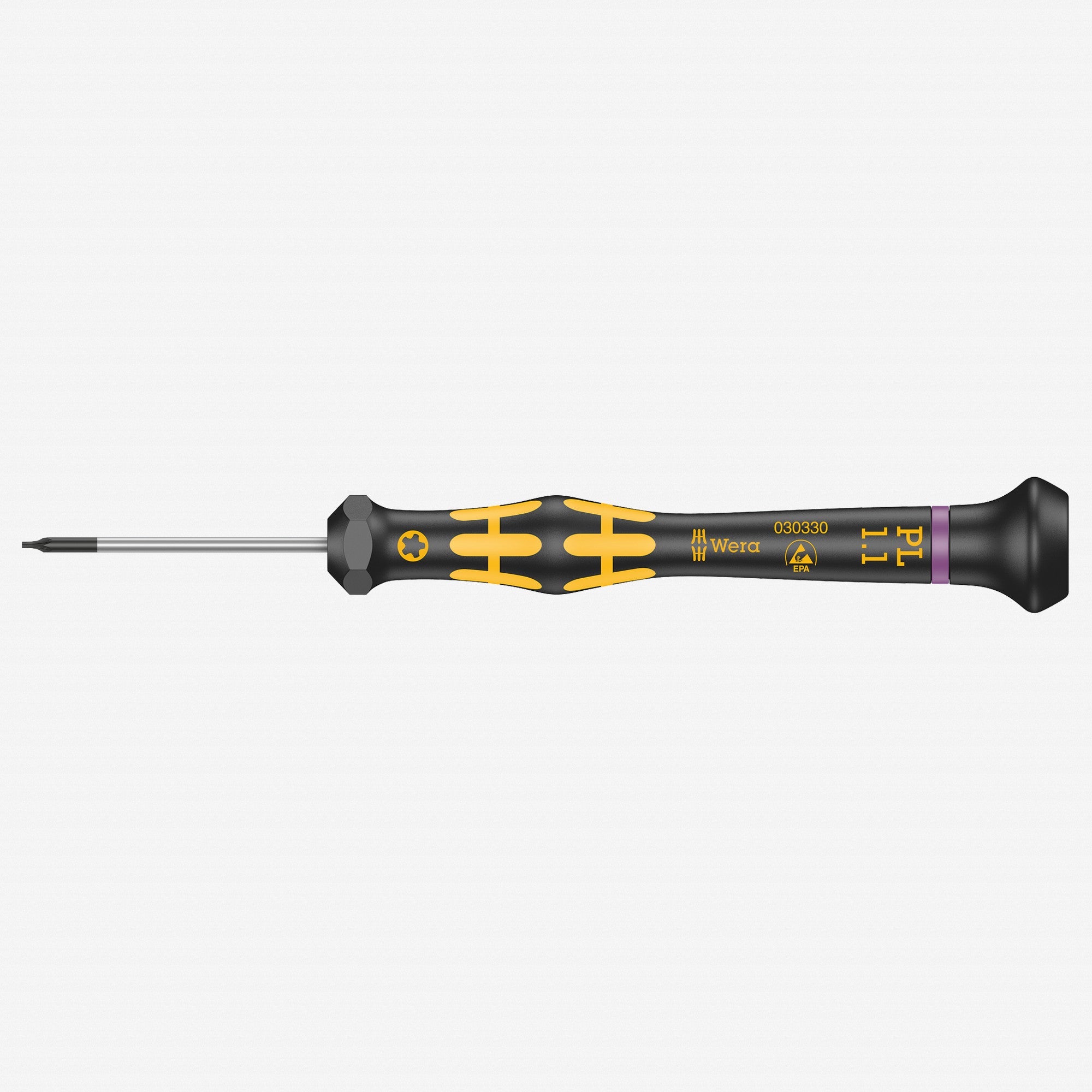

Wera:
https://products.wera.de/en/screwdrivers_esd_series_1573_pentalobe_esd.html
https://products.wera.de/en/screwdrivers_series_kraftform_micro_2067_torx_plus_ipr_micro.html
so basically they have 1.1mm (PL3... not for any apple products??) and 1.4mm (which kctool claims is TS5/PL5, maybe for some macbook batteries)

as for wera...
wera calls these PL. PL1.1, PL1.4
kctoolco claims:
1.1mm wera = PL3
1.4mm wera = TS5
notice that neither of these are the common sizes for macbook or iphone. and yet wera is being used for the repair kits. wtf?

another odd finding...

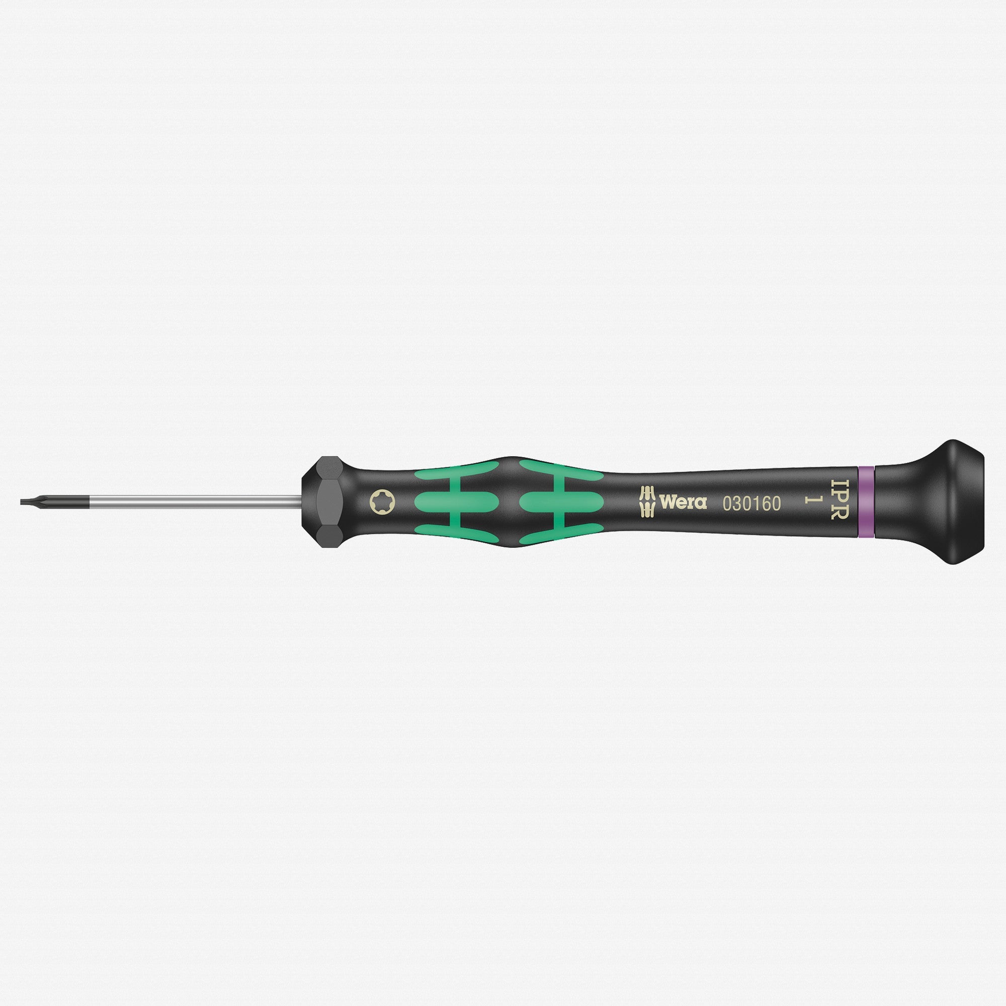

wera calls this "IPR TORX PLUS"
kctoolco says:
Tip size: IPR #1 (Pentalobe 1, PL1, P2, FiveLobe #1)
Fits iPhone 4, 4S, 5, 5C, 5S, 6, 6 Plus, 6S, 6S Plus, SE, 7, 7 Plus, 8, 8 Plus, X, XS, XS Max, XR
is "ipr torx plus" another name for pentalobe? the ****? lol

IPR is the torx plus security version of pentalobe so it should have a hole in it.

IPR (torx plus): security version of the pentalobe, 5 lobes, cog shape

IPR is NOT Pentalobe, its the 5 star Torx Plus desing as a security fastner and not compatible in any way. As stated above:
Usually IPR has also a pin in the fastners head.
So be careful with the reference to the Wera drivers as they are IPR
Wera mixed it up on their website, the symbol from the PL driver is actual IPR and i guess the small IPR sizes don't have a pin.
