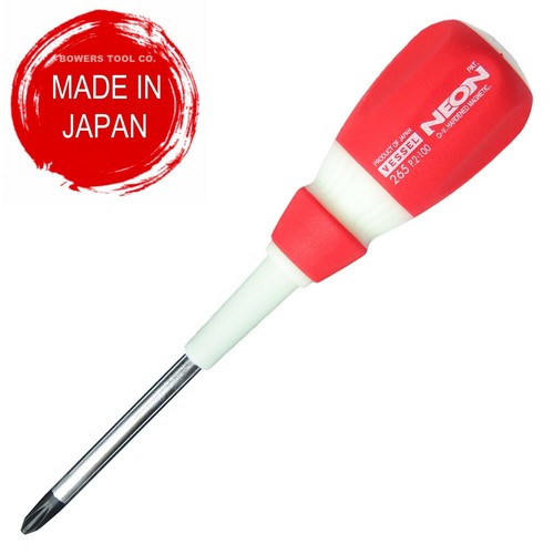

I had an issue with cam-out on Phillips heads. I bought a Vessel screwdriver and solved that. The JIS bits don't cam out.

Vessel is awesome.

it even glows in the dark:
you'll never know what you were missing until you try one.
trust me on this one, coach.
Vessel is awesome.
X4 on the Vessel screwdrivers!!!

For what it's worth, I second the Vessel screwdriver praise (I have #1, 2, and 3) in post #8. (I'll wait for more reviews on the glow-in-the-dark models!) They do a good job on gripping the Phillips heads.
