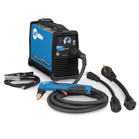

Well, since I'm finally getting a garage of my own, I'm going to buy a plasma cutter. My main use will be for cutting body panels. But, I'm sure it'll cut some 1/8" or 1/4" stuff latter. Also, this is for personal hobby use.
My budget is between $500 and $1300 dollars. Obviously spending less means I can by other toys. But, I don't want to have to replace it next year.
Given my needs and budget, what would you buy?

Hypertherm PM30, PM45 if you can swing it.
+1 Love my PM30 and I've used it for all of the items you have listed as things you think you'll use it on, worked great.

I would stick with miller or hypertherm Both excellent machines that will last, cut anything and hold there value as well
You also need quite a bit air (cfm) and it must be clean as well to properly run any decent plasma cutter
You also need to decide if you need a 110v or 220v machine
I forgot to mention I have a miller 625 extreme

I recently just bought a used Miller Extreme 625. It's bigger than the 375 and the smaller hypertherm machine yet still can do 110v or 220v. Cuts nice so far but I am far from an expert.

Any thoughts on a Licoln Tomahawk 375?
I like the idea of Hypertherm machines. But the best price I've found on a PM45 is around $1800.

You are paying a premium because your getting the one of the best machines on the market
In my opinion there are two type of plasma cutter there brand XYZ and then there's miller and hypertherm which are the snap on's of the plasma cutting world and a serious upgrade
Worst case senecio you could sell a higher quality machine as they hold there value extremely well
For what you originally stated as cutting 1/8 to 1/4. I really don't see you need that big of a machine look at the miller 325 extreme or hypertherm pm30 xp. I think that one of these would really suit your cutting needs and your wallet

I used to repair welders and plasma cutters.
Hypertherm is #1 by far. Superior design over the Miller.
That is the only time I will talk bad about a Miller product.

My last piece of advice would be to make sure the air feeding that plasma cutter is absolutely as dry as possible. A lot of moisture in the unit is the #1 way to destroy these machines.
Some of the new Hyperthem units use an electronic regulator for the air pressure which will be IMMEDIATELY destroyed if contaminated with water. Hypertherm has made it very clear that they will not warranty the regulators if they fail due to water in the lines.

I have the Miller 375 extreme. It doesn't need a huge amount of air and will run on my porter cable 4.5 gallon compressor, but it does need very dry air and it runs much better when it has plenty of power. 120v is convenient but thicker material will require 208+v service. They hypertherm seems to be popular for CNC plasma machines (they have an interface for the computer) and I am building one with my dad....................a bigger hypertherm may be in our future. For now, I have a kit to allow the computer to monitor and activate the Miller plasma.

I can only speak from my personal experience from when I used to repair these machines back around 2011. At that time, the Miller units, were prone to failure due to the IGBT's getting too hot and causing damage. I also believe they had control board issues but don't quote me on that.
I'm sure the new Miller units are just fine as Miller is a company that really seems to address its shortcomings and take care of the issues in the following models.

Well, I'll buy a Hypertherm.
The comments on moisture have made me wonder if I should wait until after I get an air dryer.
