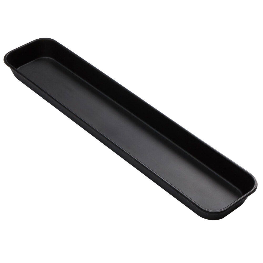

Thanks, guys - and thanks for the links! I'm in the shop right now trying to find a suitable container to use with Evapo-Rust to clean up the slider support brackets (2/3s of them are really rusty.) Hard to find something with a 28" clear bottom span, it seems.

I needed a long soak tray too. Found a different solution, but here's a couple I looked at.
