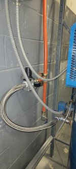

Love that Stainless flex house coming out of your compressor!
For comparison sake the 3/4" Rapid air tubing is about $2/ft.
