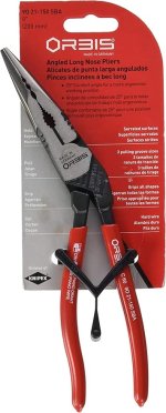

I have a pair of the Orbis ones and since purchasing about five years ago, I've never touched a standard pair of needle nose pliers since. They are much more maneuverable and user friendly in my experience. That straight line of sight and ability to pull with a stronger grip can make a world of difference.
I also have a pair of the Quinns that I bought before the Orbis. They are okay for their cheap price, and demonstrated proof of concept to me, but overall I find them bulky and inconvenient in comparison. The Orbis ones are far more streamlined and better made.
I also have the Icon ones which I like, but I got them on sale for relatively cheap. I haven't really used them extensively so the jury is still out for me on those.
