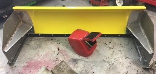

Tomorrow I will get going on my next little workshop project. I've been wanting some side wings for my JD 54" snowblade. I want them easy on and easy off . I want them to be around 2ft long and the height of the plow. Not sure how much I will use them but something I have wanted for a while. I have the metal and some yellow paint in my shop so it will be a low cost project. Here is a photo of someones design that I liked. So I will build it on this idea . It doesn't have to be heavy duty for my little JD X-758 .

This morning I marked out the lines on the metal and got busy with the plasma cutter. Got a nice start on the side wing parts . Adjustable skids done and bending the mounting brackets now. We get 80% powdery lake effect snow so I think these wings will work great moving much more of the fluffy stuff at a time. :thumbup:

More progress today , I drilled the holes in the blade to attach the curved plates. I also now have the wings welded to the plates. Tomorrow I will cut out all the gussetts and get them all welded in place. Not spending very many hours a day in the shop with these very cold temps.

Here is the next step showing the center braces now welded in place. Next I will cut out four 5" x 8" gussets for the top and bottom corners. Then a couple 1/2 inch braces along the edges. That should make it nice and sturdy but still not too heavy. I should get it done and painted tomorrow.

Snowplow Wings- It's been several years since I built these folding wings for my 5000 series John Deere. They worked great for 18 years of doing snowplowing. The blade on the Waldon loader was a rear blade converted to a front blade converted to wings , then got a floor and roof and now been used as a light duty snow bucket for the last five years. These little wings should do the trick.

JD 54" Plow Wings- The wings are 20" long and 17" tall. I used them today for the first time and I absolutely LOVE them. What a day and night difference they made. The snow used to spill out both sides so bad and now I can carry 3 times the snow as before. Very happy with the easy mounting system too. My wife just downloaded two You-Tube Videos if anyone is interested ?? of me using the new wings. Nothing fancy but another fun little project. One week ago I had no idea of making them and now they are done and work great. :rocker::rocker::rocker::rocker::rocker::rocker::rocker:
