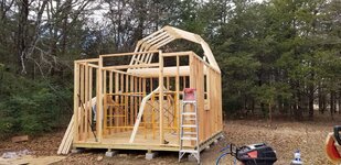

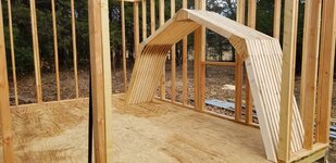

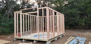

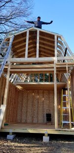

I built a 12x16 shed about 3 years ago so the lumber prices were definitely lower however, it was also about $1500 cheaper doing it myself when I compared it to one of these prebuilt ones that's common around here. I basically stopped by one of the shed places after hours and took a ton of pics of a shed I liked, then went home and figured up the material list. I also got to change up a few things in the process. The best upgrade was going with a roll up door and adding a loft. I never did take a final completion pic but it's still standing and stays dry. I ended up taking the roofing felt off and going with the vinyl underlayment.
Even with lumber prices being high right now, I think pricing it out apples to apples, it would still be cheaper to build yourself.20181129_171547.jpg
Welcome to GJ George.
Looks like a nice build you did. It appears you went 16"OC rather than 24" and used 2x4s rather than going cheaper with 2x3s like some pre-builds use.
