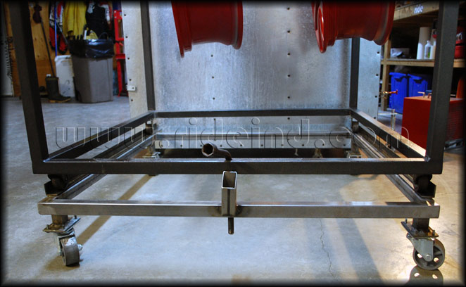

CudaChick1968
Member Emeritus
Jul 1, 2011
1,800
Northwest Tennessee (38230)
:D ... subscribed. A few years ago I was in the same boat you guys are now. Here, you can borrow a paddle.
Tough to believe it's now been five years since I finished and installed it ... but it was the single best investment of time I've ever made and the days of losing a job because my oven was a half inch too short are gone forever.
