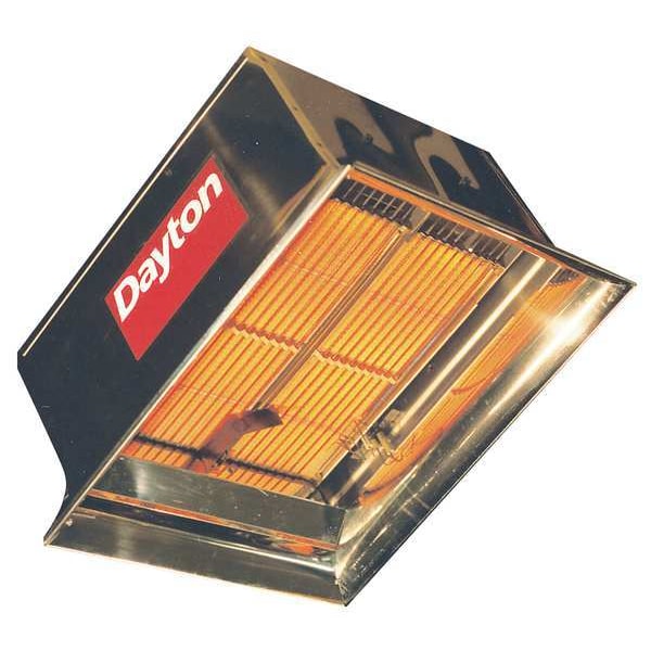

My situation: Our second home will hopefully become our primary residence in the next couple of years. It's located in SW Wisconsin.
We have a 30x48x14 pole shed that's very well insulated with closed cell foam. The walls are finished, but it's open to the trusses (roof is also insulated). We use it for storage of equipment, a garage, and a party space for an occasional hootenanny. For reasons known only to the gods, in winter the interior temperature hovers around 25-30 degrees above the outside ambient temperature (it's completely draft-free, and I'm guessing that the thermal mass of the concrete, gravel base and ground, combined with excellent insulation, help moderate the temperature).
We're on LPG. Natural gas is not an option and our electrical rates are pretty high. I'm not interested in keeping the building heated 24/7, only having the ability to heat it when I'm working out there or gathering with family and friends on a cold day. It seems to me that LPG-fueled infrared heat is the right answer for my situation.
Is this sound reasoning? If so, what type of equipment should I consider, and what design attributes should I be looking for?
The tube heaters seem to me as though they'd be a good solution for this type of application, a la this type of design:
Or, would I be better off with a two or three units like this:
Good brands? Bad brands? What else am I missing?
Thanks in advance.

We have the Dayton units at my work in NC. They are on natural gas but the LPG should heat similar. There are 6 total heaters in a 100' x 30' shop which has five bays. A roughly 30-40 x 30 section of the shop has no bays but is used to store equipment and stock such as oil filters. Each of the five bays has a 30000 btu Dayton like your bottom picture centered in front of it opposite the bay door. Each of us mechanics has our toolbox and workbench under one. Granted it doesn't get cold in NC like other parts of the country but we can come in on a mid teen morning and the building will be in the high 40s. We usually run four units for about two hours. After an hour run time the building is warm enough I usually pull off my jacket and work in short sleeves. After two hours we usually turn off two or three of the units. One guy is cold natured an runs his all day long. Mines off after two to three hours and I'll occasionally flip it back on of someone has opened a door for a long period of time. If the morning low is between 30-40 degrees we only run one or two heaters initially. Ours are about 6' in front of the bumper of a car if its lifted. I've never seen a car damaged by the heat nor noticed any rust on my tools not that I doubt the above posters advice. We did have a guy that hangs out every afternoon sit under one for three hours on a stool one day and his hair started smoking LOL
