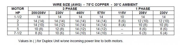

The number of amps and voltage gives you the max true horsepower that the circuit will support. Per http://www.engineeringtoolbox.com/electrical-motor-calculator-d_832.html the most you can run is a 5 HP motor, and that disregards the need to overrate the circuit to account for any start up surge.
I run a true 5 HP motor on a 30A circuit, and some would say that's pushing the limits, but I've had no problems with it. Cutting it down by a 1/3rd, I dunno. I'm a little skeptical about the 12 ga. wiring too. IIRC the motor plate on mine shows a 22.5 amp draw.

FWIW the attachment is a screen shot of electrical requirements from a Champion manual, to give you an idea what compressor manufacturers recommend for wiring.
