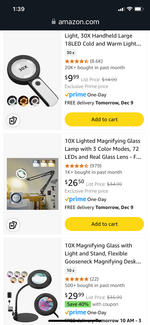

Doesn't everyone wear these things?
I have those very Yoctosuns and they are way better than you’d think for the money. The switch for the light seems super fragile and the lens mounting feels like it will eject the lens. But optically it is excellent and the headset is very comfortable.
As I discovered the other day, the lens mount will eject the lens if brushed. It wouldn't have much mattered had I not been standing on a ten-foot ladder at the time. Lens chipped some when it hit the concrete, but still usable.
