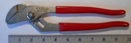

Wilde
Proamerica
both grossly underrated.
way more bang for the buck.
30,053
^ Wilde supplies Tekton on several models.
Wilde was also a major supplier for Craftsman, as well as a few others.
Proamerica is a supplier for military/government contracts as well as Proto and some other brands.
It's difficult to ferret out who supplies what to who because manufacturers do not generally make that information available.
Wilde and Proamerica at MSRP can appear to be a bit spendy. Most of what I own of each was purchased on Ebay, primarily from sellers bowerstool or donvito-ny.
Some of the Proamerica I purchased in one lot during a "Black Friday" special a couple years ago: http://proamericatools.com/
Every now and then some Wilde will pop up on Ebay that's military/government surplus - new stock at fire sale prices:
https://www.ebay.com/itm/Wilde-6-1-...767598?hash=item3d4fea69ae:g:nBgAAOSwqKNZnMvX
https://www.ebay.com/itm/8-Plier-Wi...460338?hash=item28471833f2:g:3CEAAOSwNdBZdLoN
* Searching for Proamerica on Ebay can be puzzling - many sellers have it listed as " Pro America " (two words) instead of " Proamerica ".
* btw: bowers tool just added Knipex to their offerings on Ebay. I have no clue whether or not the prices are high or low - it's not one of the brands I've delved into:
http://stores.ebay.com/bowerstool/?_dmd=2&_nkw=knipex
* After perusing Proamerica's web page I suppose I should note that there are some Proamerica models that are available only from Bowers Tool on Ebay.
