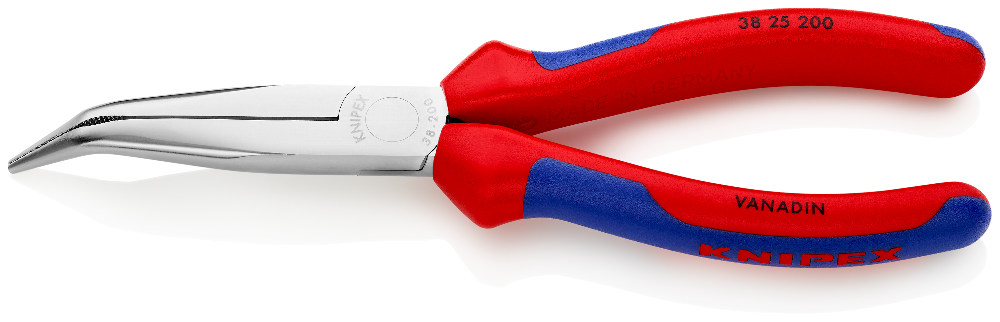

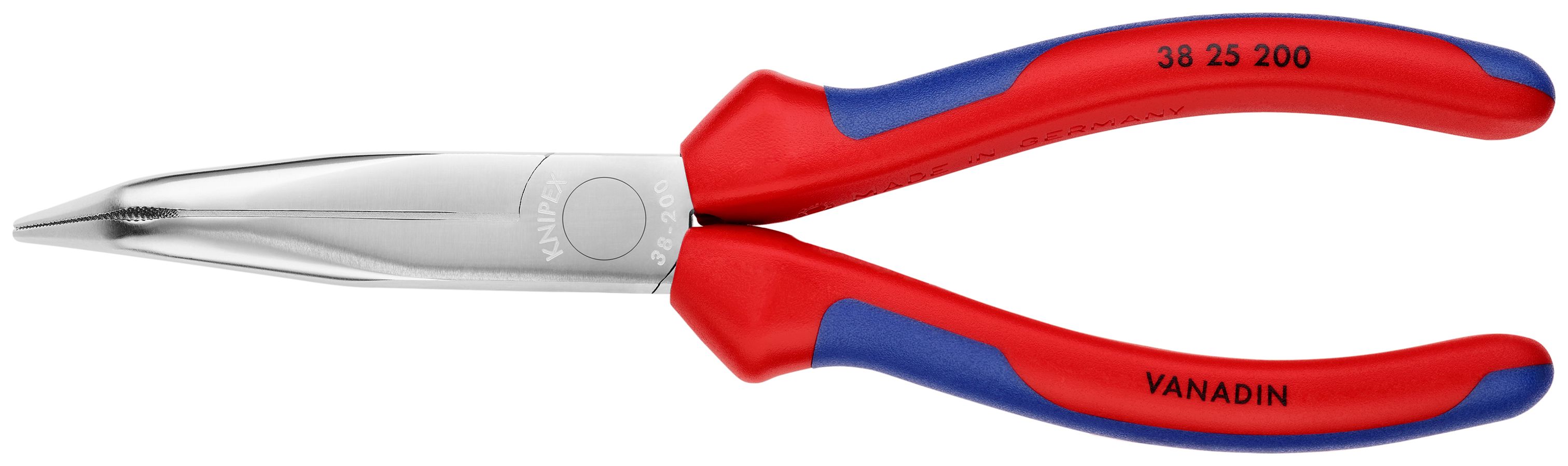

Knipex 3895200
Or Knipex 3825200
Both also available with dipped handles.
German links provided for better pictures.

Not to dampen the enthusiams of replies, but re-readin the OP, seems he is asking for working range under 1/2 inch or 13mm
Hose size is 3.1mm I.D. x 5.7mm O.D.
I mention this because it seems the working ø range for standard hose clamp style pliers is something like 15-30mm. See, for example, this orbis extended reach hose pliers.
Also, it seems most of the pin-holding or bolt-holding style needle nose seem to have metal-gripping teeth, vs something suited to more fragile applications like flexible rubber type fuel lines and what not.
For other options, while you can certainly go to a 30 or 90˚ bent needle nose, question remains if that is the best option or not, given that the needle-nose-jaws can be a bit hit or miss for hoses in general.

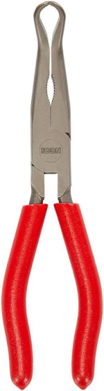

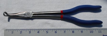

29,581
Unless I am mistaken, the smallest production-made pair of "hose grip pliers" is the 5047 ProAmerica (most likely made to the same dimensions as that "Gearwrench" model in post #24)
The model 5047 is billed as a " 5/16" " size, but I'm not sure exactly what they are measuring.
In any case, they are much larger than any hose you're going to find on a chainsaw (or lawnmower, for that matter.)
The ICON model posted above is also too large, as are the Knipex models shown above.
Which begs the question:
Why would a curved jaw pair of surgeon's forceps not work?
It's not like those hoses are torqued down to 90 foot pounds.

These work great or can get icon for more $, I also like the duckbill ones for the clamps, together makes a good set.
Ditto on the mundane HF hose-tuggy set. I got this set maybe ten years ago, they don't look high quality, but they keep working for me. (No specific experience with small motor fuel hoses, though.)
The hose tuggy pliers made by Knipex and HF ICON, based on a 6" needle-nose pliers, are for larger hoses -- and very nice to have! But not for this job.
