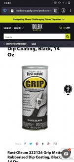

Depending on the pliers just remove the grips and then get some dip and dip them. The rust oleum brand stuff works good enough. Unless they are nicer higher end pliers. In that case return them.Screenshot_Fennec_20201026-111458.jpg
Sent from my ONEPLUS A6013 using The Garage Journal mobile app
I definitely ain't going to find that in my hardware store :lol_hitti
They're some vintage Harry P Will pliers so will see if they have another unit I can replace it with.
Worst case scenario, I think the glue lined heatshrink will serve me well.
