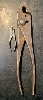

I don't think my pair and his "McD" pair are the same at all.
That’s what I think too, but one issue is mine are 8”, which I think will throw off the apparent proportions. If the pivot nuts are the same, I’ll lean toward they are same mfr, maybe different years. Thanks for forwarding yours to me.

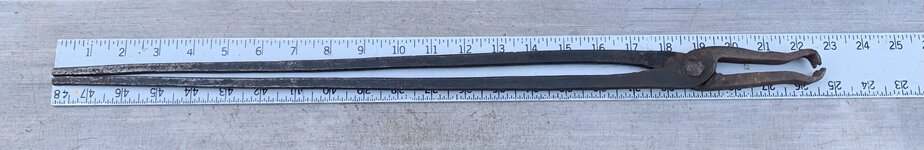

Today, I brought home my longest pair of pliers. Compliments of the scrap bin, again.
No maker's marks, aside from hammer dents. I suspect they qualify as vintage, but I could be wrong.
I suppose you could call them tongs, but I don't have a tong collection; or a tong drawer, yet.
