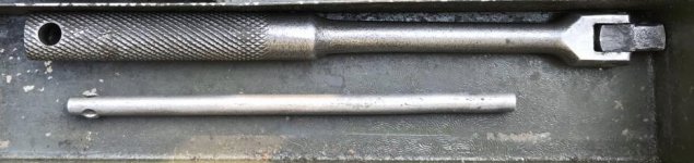

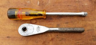

The coolest Plomb snag was the female reversible 4748 1/4-inch drive rat, which appears to be 1938 production. It is missing its push-pull drive plug. I pick them up whenever I see them, in all drives sizes, so I may have something that can serve as a suitable placeholder.
I never thought I'd call a 4769 spinner-extension hum-drum, but it looks it next to the 4748, and as you can see, it is ossifying a little inside the composite handle.

Don't be a tease. Let's see that female ratchet.

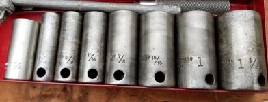

I'm not sure what to make of this Cub drive extra deep socket set. I am drawing a blank and I don't remember seeing one before. The box has no number on it. It looks too new to be original finish, although there is nothing under that paint except steel. It seems to be missing two (2) sockets, almost certainly a 3/4" (the 3/4" that is in there does not belong) and maybe a 1-1/16" (since it skips from 1" to 1-1/8". I can't seem to find the model numbers, all followed by an "SP" (probably for Special), in any catalogs. The handles are a WF-20 and a WF-22. They will turn the sockets, obviously, and they both fit inside that slot behind the socket compartment, but I doubt the original handle was a "WF" series. Probably a 52xx instead. And the sockets are cross-drilled for turning with a pin handle as well.
If this has been covered and other examples of these sets are here on this thread somewhere, someone please post links. Thanks.

I think the SP represents Spark Plug. I know it's in a catalog somewhere. Your suckage is piling up quickly.
Thanks for posting the pics of the ratchet.
Doh! That makes much more sense!

Dang Lugz! Quite the day you had. Love that female 1/4” ratchet.

The only standard 3/8-inch drive deep socket I have is the one that came with the set, but didn't belong in the set. In Pic 1 below it is shown to the right of the SP sockets with my PWA marked 3/8-inch drive deep socket. And the larger socket to the right is a standard 1/2-inch drive deep socket. As you can see, all the SP sockets have a hard black composite bushing-like insert.
Pic 2 & 3 are catalog excerpts from Catalog 18-A (1941). Page 34 (Pic 2) lists the SP sockets individually, shows a cutaway view of the socket (including the insert), and refers to page 15 for the set. Page 15 (Pic 3) shows the set.
What I have is Set No. 5000 SPA. It looks like it came with the pin handle to turn them (through the cross-drilled hole in the base). That's what goes in the space behind the socket compartment, not a hinge handle or a sliding tee. And it also came with an adaptor (5400A). That is why I thought I was missing two sockets. That extras space is for the missing adaptor. You can see it in Pic 2 and all the way to the left in Pic 3. Honestly, I am not exactly sure what the adaptor is for.

Lugz, #5240 is a spline adaptor for 10mm spark plugs. See page 35 of the Catalog 18A, with the illustration on page 34. The #5266PH pin handle is the standard one for the 3/8 drive handles.

Ah, got it. I will be looking for one - and a pin handle now. The latter may as well be a needle in a haystack!
Every Plomb pin handle seems to have a crimped end vs a ball dedent. I have quite a few pin handles as I pick them up like ratchet plugs due to how rare they are bit still yet to find a Plomb one.

Modern 10mm spark plugs have a 5/8" hex. I suspect that the #5240 adaptor was for a version of spark plugs that used a spline instead of a hex.
Take-apart spark plugs were obsolete by 1940, except for BG aircraft spark plugs. The spline may have been for an early take-apart 10mm plug, with the spline used on a retaining nut for the insulator. It would be interesting to see an old spark plug catalog to check this out, but I have never seen such a thing.
