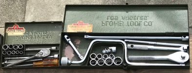

Thanks, guys! I took some time today to clean up the box and the tools and each tool had the indentical date code from 1939. Here are some pictures after cleaning.

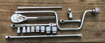

Here's something I forgot that I had. I put it in my computer room, and then covered it up. It's missing a lot of the original contents, but it's still unique (I think).
I am very happy to see that, Don.
Carla will be even happier if she's reading, or if I can remember where we had the conversation (me, Carla, twertsy) about when Plomb first introduced the Challenger sets, I would link your post.
Here's why.
First use of the "Challenger" term for socket sets in print by the decades-spanning Plomb/Proto/Pendleton empire, as far as I can determine, is page 24, Catalog 18-A, printed October 1940. Carla has reported that she has a complete set, in the original box, with all her pieces also date-coded 1939. The big difference is her box had no decal identifying it. She identified it as a 5200X Challenger set by matching its contents one by one to the 5200X set in Catalog 18-A.
That lead me to postulate that Plomb may have introduced them in late 1939, after Catalog 17-B was published. (The Challenger sets are not included in Catalog 17-B.)
Your set now confirms that postulation.
Fantastic, omt. First one I have ever seen.

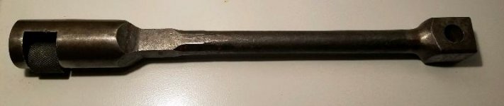

Picked this up the other night, for $3 off a local for sale app. Lady inherited a box of her grandfather's tools, found this. She had no idea what it was. I knew right away by looking at the end it was a stud puller. But not like any Plomb stud puller I've seen. It's stamped Plomb, with the arrowheads, round O. The serrated part is also Plomb stamped. No other numbers except for the 2. I'm thinking maybe a contract piece? The hole is 1/2", OAL is 15". The only way to turn it would be by using a bar in the other end. Any ideas, guys?
The only thing I know about that piece is I do not have one. Very nice piece. Will wait for the experts to chime in.
Smokeshow69
8,425
Very nice piece ! Wonder if it is an early piece maybe for engine head studs or something with smaller studs than wheel studs ?
You ****:dunno:
Round O stuff is right near the beginning of part numbers, so just having a 2 isn't that surprising.
Something tells me it might be more of an installer than a puller.
It looks like the tool could also be driven by an end wrench, 4, 8, or 12 sided socket on the outside, and possibly retained to a power drive machine by the pin hole.
I definitely have not seen anything like it.

When you get a chance, would you be able to mic the pin handle?
Slew,
Here you go. It mics out at .311”. I assume that would make the holes in the flex handle and extensions around 5/16”. The nice thing about this particular vintage of Plomb tools is that there are retaining balls in both the flex handle and the extensions to help center the crossbar. They did away with that feature shortly thereafter.
That’s really neat. I was looking at the old catalogs at Tool Archives. It’s in there.
Check out the 1928 and 1929 catalogs.
Ah, yes, there is something similar there, at least same basic principle. I'm thinking the one I have pre-dates the '28 catalog. Mine has no date code, and is 15" where the catalog has 18". The catalog one has the puller end like the regular small puller. I have several other pre-'27 pieces in my collection, so this will go with those. I'm just starting to run out of room to store all the Plomb.
That's a really interesting early piece. Here are the more typical Plomb stud pullers (with 1/2" WF ratchet for size comparison.) Biggest is 3/4" drive, and is quite hefty.

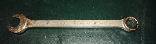

BB,
That wrench looks kind of familiar. I do like those sockets, though!:thumbup:
Here's why.
Yes, I'm quite impressed with Don's Challenger set. I should think it quite a rarity, to have survived so well all these years, as it has.
Something which isn't obvious from photos, tho, is the difference in aesthetic finish of the pre-war tooling, compared to the post-war chrome-plated tool production.
The pre-war stuff was given a much higher grade of polishing, and the markings are clear and deep. I should imagine that the quality of the steel, and the dimensional tolerances are reasonably equal between pre-war and post-war production, but the care taken in aesthetic work was rather dramatically superior in the pre-war tooling.
And....just for the record.....the Challenger set I have is the '5400' series, 1/2" drive.
cheers

As I drifted off to sleep dreaming sweet dreams of one day finding a set in the box , let alone a challenger set, I figured I would post a few pictures of my 1/4 drive set in its metal box.. The paint is in ok condition given its age but the sticker is pretty nice ! This is the set that is missing a few sockets, t bar and ratchet!
Rileysan
Sep 11, 2015
4,298
Milwaukie, Oregon
