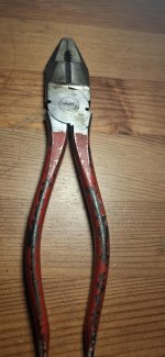

Hello. My mother found these tools in her attic and passed them on to me.
I would be happy to receive any information about them, such as whether the tool is high-quality or ordinary, production dates, and any other information.
Thank you kindly in advance!
Michael

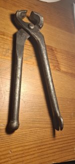

Hi. The end nipper in the first post is EA Berg. Eskilstuna Sweden. That’s Erik Anton Berg. They have some age to them.
The second nipper is Smalcalda if you can’t make it out. Also some age to those. Looks like some nice European made stuff.

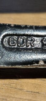

The final pair also look like nippers, I can’t read any of the lettering but GDR, and I don’t know that Germany called themselves that, I think it was DDR. Germans love compound words, so try breaking the long word up into smaller fragments and run it through google translate.
30,999
The "GDR" is the German Democratic Republic, or East Germany. "Smalcalda" - as @3baygarage identified above - is a sort of brand name version of Werkzeugkombinat Schmalkalden, the formal name of East Germany's state-owned tool manufacturing combine. Those are Cold War end nippers from the other side of the wall.
But, DDR is the name they would be using inside East Germany, no? GDR I would expect if exporting to an English speaking country. I thought (scary eh?) that East Germany wasn't manufacturing for export, they were only making for internal consumption. I assume then that you are saying they were making for export outside the wall.
Stolen from AI do I don't have to retype: DDR (Deutsche Demokratische Republik), or German Democratic Republic, was a socialist state in East Germany from 1949 to 1990
This ^^ is what I was taught in HS, long before 1990.
30,999
East Germany's foreign trade was dominated by Soviet Bloc/COMECON partners, but not exclusively. In the 70's into the 80's - when I suspect those nippers were made - Western exports, including the UK, may have reached as high as 30%. They needed the cash! My understanding is that the "Smalcalda" is also anglicized for English-speaking markets. I see the "GDR" most often on axes.

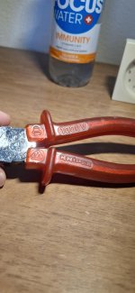

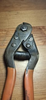

Hi again.
Some more tools I received.
Strange pliers (Polish):

May 22, 2021
21
Oddly designed pliers, made in West Germany:

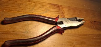

May 22, 2021
21
And another heavy and well-designed pair of pliers

Your last post - Stubai - is Austrian:
Stubai / Stubai ZMV GmbH / https://www.stubai.com/en/start-2/ / http://progress-is-fine.blogspot.com/2018/03/german-austrian-wrench-makers.html /
"Poland" in Polish is Polska, so I can only assume your Polish nippers were manufactured for the export market.
You might find a match to that logo on Wolfgang's website:
https://www.holzwerken.de/sitemap.phtml
"HiT" is the trade named used by Toho Koki
Toho Koki / Toho Koki Co. Ltd., 2500, Koizumi, Yamatokoriyama, Nara 639-1042, Japan / "Hit" / http://www.hittools.co.jp/eg/main.html / est. 1938 / http://alloy-artifacts.org/japanese-tool-makers.html#toho-koki /
I don't recognize the "Made in Western Germany" pair at all - perhaps @Eric Brown might shed some light there.
The 180 nippers with the odd stylized "A with an arrow" logo is puzzling: is that character Cyrillic? :unsure:
