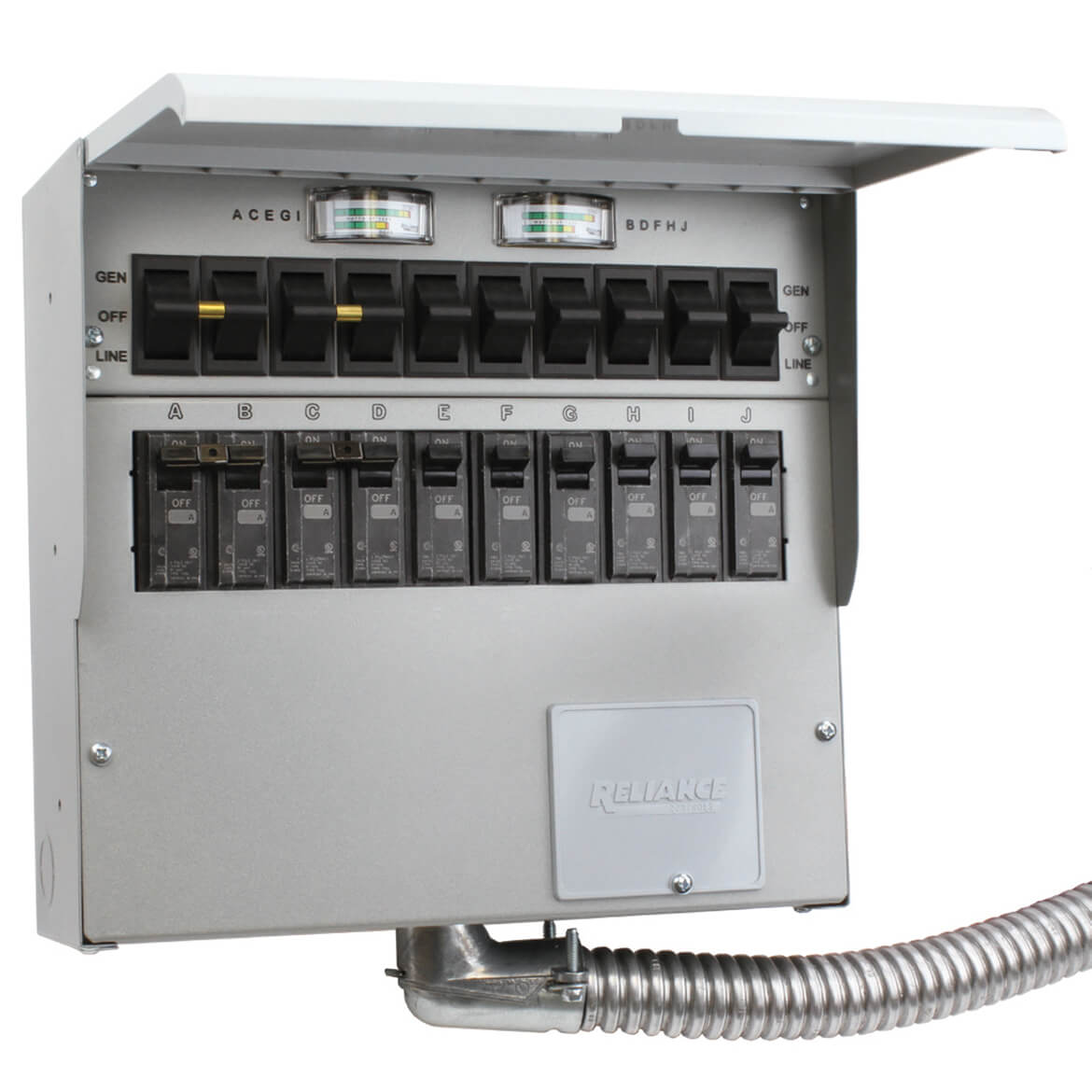

There is another type of interlock that reroutes a set number of circuits (usually about 6-10) through an external switch that is connected to the generator, and it is used to switch those circuits between generator and commercial power. Its not really that much more complicated to install if you don't mind some quality time with wire nuts, and its more flexible than other options.
This is the type of switch I am talking about. I don't know anything about this brand and its quality.

that isnt an interlock. its a manual branch circuit transfer switch
