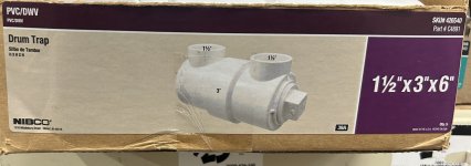

Was in the orange box store the other day in the plumbing isle.
Saw a PVC "Drum Trap" and was curious what the hell it was and how it would be used.
Quick google did not tell me why someone would use this over a conventional trap.
Any plumbers here to explain why and how this would be preferred?

Clearance, as far as I know, but I think they were really only used up til the 70's ish and I don't know if they are compliant anymore. . I had one in my last house for one of the showers (1970 build), although it was brass and smaller than that pvc one. P traps are much better as they self clear
When I renovated one bath, I went back with a p trap, but I changed the drain location. I bet the only time they would get used today is to replace an existing one, by someone that probably shouldn't be plumbing

In general, they are not allowed in new installations. Replacing existing ones is generally allowed, because extensive reworking is often necessary to get rid of one. As you note, they are not self scouring, so they clog easily. There are some places where they are allowed where the lack of self scouring is desirable. The sinks attached to dental chairs have one, or similar, so when someone spits out a crown or something, it can be retrieved.

Drum traps are mostly an older design, usually found in older homes or specific tub setups where a standard P-trap doesn't fit. They are rarely used in modern builds because they clog easily.

I cut one out of a lab at Cornell in about ‘72-3. This back in the day of mercury thermometers for temp..Had a hand on the bottom of it. When it came loose it took me to the floor. It was filled with Mercury from decades of broken t-moms. We then went to the basement with a bucket and about filled it when draining the building trap.

I seem to recall drum traps in the art room at school (clay and paint) and I know I had installed something similar in the hand wash sinks at the boatyard. Was easy to unscrew and dump the sludge...

I've seen something similar used outside in basement entry stairwells to drain rain water where you might also get debris like gravel and sand in them. You actually want the trap to catch that stuff so you can clean it out instead of having it go down the drain.
