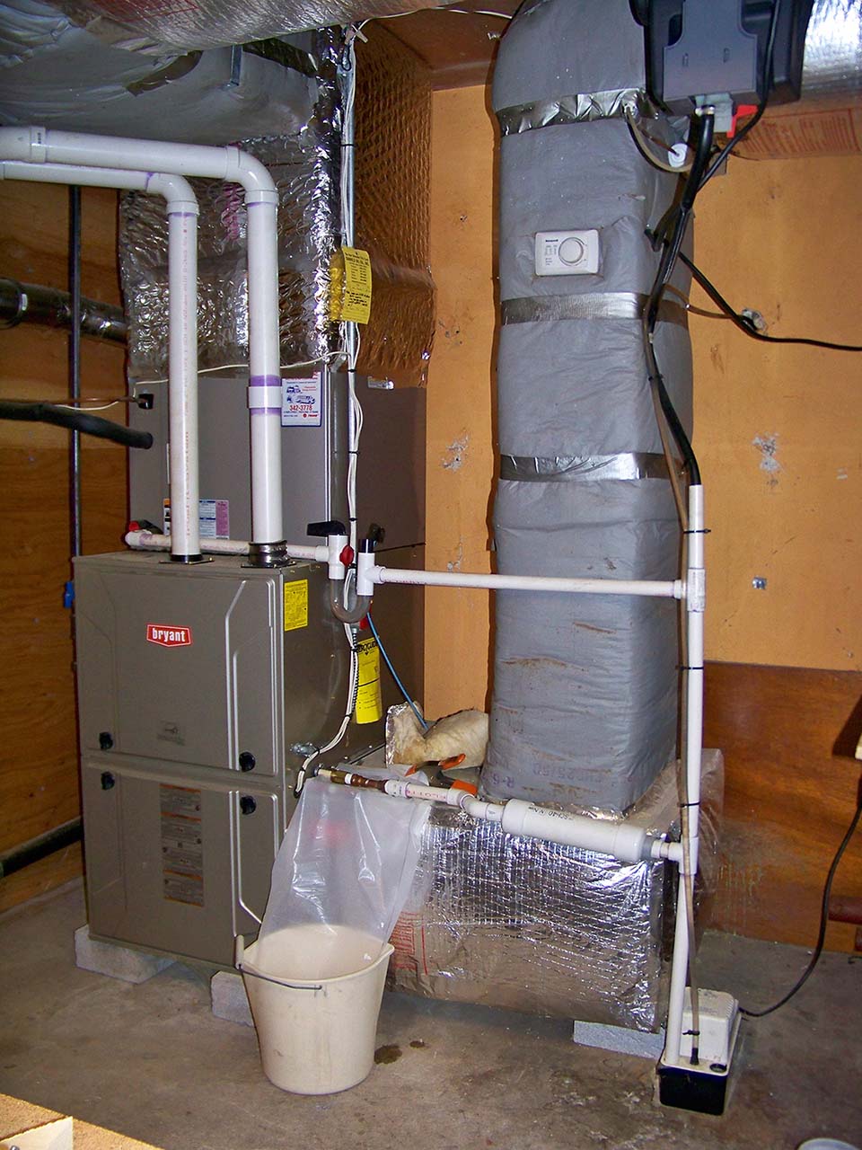

I have 2” ABS DWV pipe leading to a drywell which provides drainage for a utility sink, washing machine, forced air gas condensing furnace with A/C and steam humidifier.
The furnace w A/C and humidifier are in the garage. Behind them, separated by the utility room wall, are the sink and washing machine.
The furnace, A/C and humidifier drain into a condensate pump which pumps the water up through the wall and into the same inlet as the washing machine.
Since the 2” DWV pipe passes right next to the furnace (1ft away) I would like to get rid of the condensate pump and “T” into the DWV pipe. If it matters, the pipe distance from the washing machine to the furnace is about 10 ft.
The furnace condensate drain is 21” from the floor.
The 2” DWV pipe is 6” from the floor, thus leaving me 15” from furnace drain to DWV pipe.
My thought is to put a properly directed “T” into the DWV line with a trap and Oatey Sure-Vent.

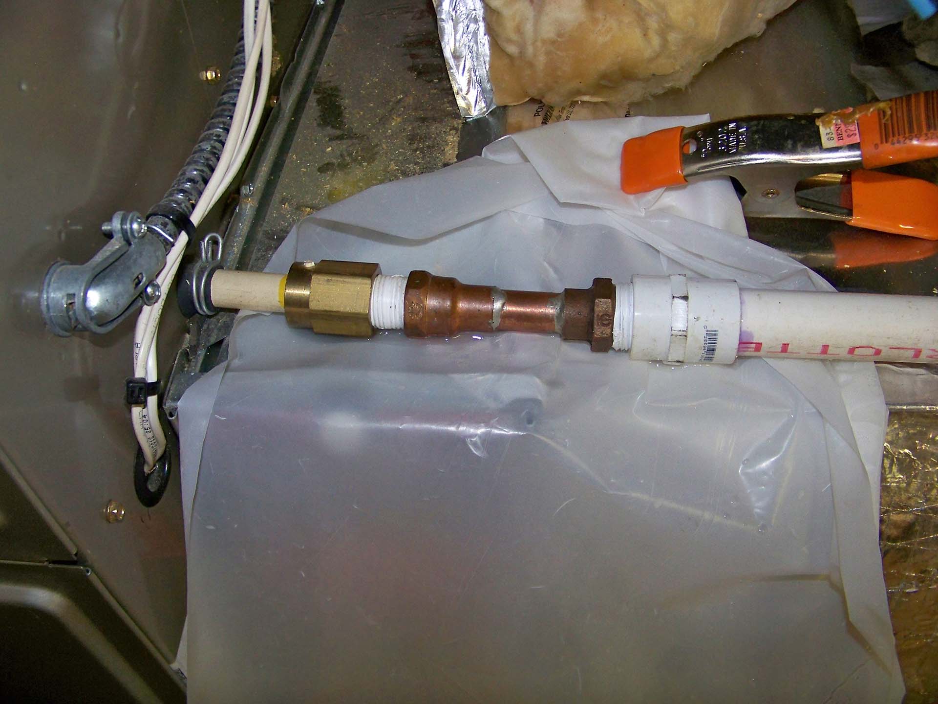

I'll try it without the check valve and see what happens. This all started cause the furnace condensate line started leaking yesterday. Looks like a MacGyver Job (that was done by a "professional"). I don't think you're supposed to use copper there. I was just thinking if I have to mess with it, I might as well clean it up and simplify it. I'll exit the drain from the left side of the furnace.

Why in the world was the install done that way?
I haven't done a 90 plus install in a long time,Ill see if I can find a picture for you of the condensate drain plumbing fo you.;)

Heres a picture of a basic set up,not one of mine.Your humidifier drain can just be ran into extra hole in pump.

The "extra" plumbing (copper) was added after I complained that the furnace was making a high pitched noise unless I removed the air filter. I read the manual and when I got to the air filter section, I realized they had used my old much smaller air filter duct work rather than install the substantially larger filter box that came with the unit.
I see in the last picture they chose not to use a trap. not sure what the purpose of a trap in that area is anyway. The manual says that a trap is not required on that line unless it is required by code.

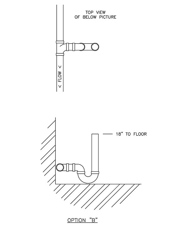

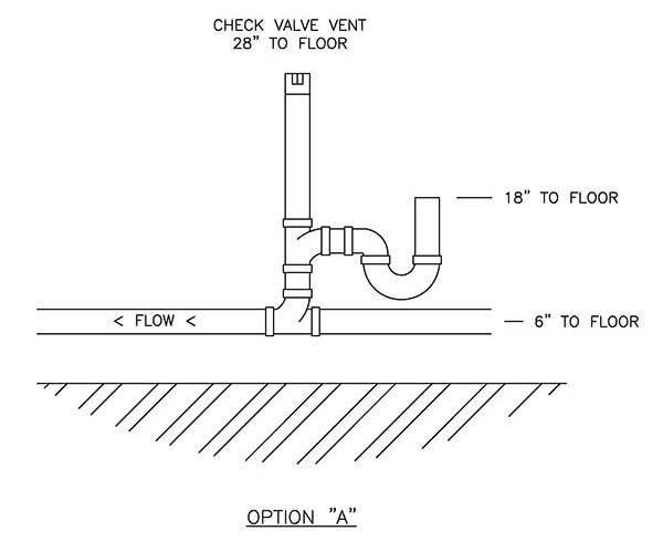

Here are 2 options. Which is better? Is there anything wrong with going the Option "B" route? It's certainly simpler. If the trap is below the DWV line I see no reason to put a vent in.

Substitute a wye for the san tee in the main line coming from the washer,use no hub couplings to connect the wye to the existing line.(not ferncos)
Abs fittings are getting tougher to find atleast around here anyway,do not glue abs/pvc fittings together.

If youre going to do it Id make a stand pipe like for a washing machine coming off the 2" abs pipe.
Then run the drains over to it,make sure to leave some sort of air gap between the stand pipe and the drain lines.

OK, I'll put a Wye on top. There should be plenty of air gap either way since I'm putting two 3/4" pipes in a 2" ABS opening.

Terminate the pieces of 3/4 just above the 2",also laying the wye on its side instead of up/down will gain you a couple inches to run the 3/4 above the 2" easier.
Just make sure you have a little fall back to the 2".
