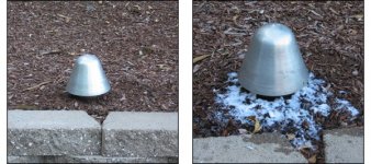

Never heard of a ground level vent in the yard.
Maybe the OP is talking about a backflow prevention device.
Here's a pic of the type commonly used in my area. The second pic is debris (TP) left on the ground rather than back flowing into your downstairs shower pan if and when the main sewer line gets clogged.
