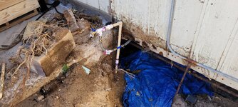

Days 19 & 20

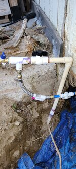

Got a rip roarin start yesterday. I dug out the "hole" more for better access. First thing we noticed was an outlet, electrical outlet had been installed under the house. This is a mystery, nobody knows anything about it or how it got there. If you noticed the pvc piping on the wall, there was at one time a water softener there. I'm thinking the outlet was installed by the company to plug in a meter, I do know that it (the outlet) was burned up and melted. Story is that 10 years ago, this side of the house started having electrical issues, blowing fuses, so bad that a new fuse box was added outside and this side completely re-wired. I bet I can guess what the issue was...
We had decided to remove all the water softener lines as part of the project AFTER taking care of the clog. That plan changed when her brother inadvertanly kicked the inlet pipe, breaking it and sending water everywhere. Shut off the water and re-grouped. We decided the easiest, quickest way to resolve this would be plex hose and sharkbite fittings. Mobile home plumbing is different than a regular house. The majority of the lines coming in are plex and push fittings and it really ***** having to work with them. We put together a list of fittings and hoses, one being a transition from plex to pvc. This stuff is expensive, I walked out of HD about $85 lighter. Got it together and guess what, that transition piece leaked. No problem, its Sharbite, we'll just pop out the hose, no. Freaking thing will not release. I've got the stupid little orange tool, it don't work, I've got quick disconnects, they don't work. Cut the F'in line and start over. Instead , this time we go to Mobile Home Depot, a HD for , well, mobile homes. Its been about a year since I'd been inside and now they carry an off brand version of Sharkbite at a fraction of the cost Should have gone there first.
The whole day Saturday was a complete clusterfrick, but we did finally manage to get rid of the water softener lines, roots and all, got the shower drain hooked up and finally, finally got a shower. As it stands right now, we have one fully functioning bathroom and shower, can do laundry and use the kitchen sink without anything backing up. The master bathroom has not overflowed but is still down. Her brother brought up an idea, instead of crawling under and cutting the line, we couyld access it from above. remove the toilet, sink and vanity from the front bathroom, since its right above our target. Problem with that is, if there is an issue that puts a stop to the work, now we wont have a toilet or shower again and the way **** flows around here, you can bet there will be a problem. A few hours later that idea was scrapped. New plan, we know a guy that if we pay him, he'll go under and do the dirty work. Can you tell neither one of us want to go under there? To be continued...WEST ACCESS.jpgWEST ACCESS 2.jpgWEST ACCESS 3.jpgSPIGOT.jpg

If you care, some of those cheaper push connectors for plumbing are one time use only. Menards here sells plastic push connectors that are pretty cheap, but I am pretty sure they are one time use. I wouldn't trust them long term, but I bought a couple of the caps once for temporary use.
