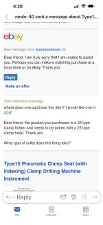

Ebay seller replied its takes a 25 Type closer. Have not had anu luck finding such an item. Waiting on reply on where to purchase?

I'm confused, are you looking for a collet or a closer?
These threads are very unclear

So you are measuring a holder, need a collet, and the seller (who sold you the holder?) told you it takes a "type 25 closer". Is all that right? If so, why did you buy a holder for collets you don't have, without knowing what it takes?
