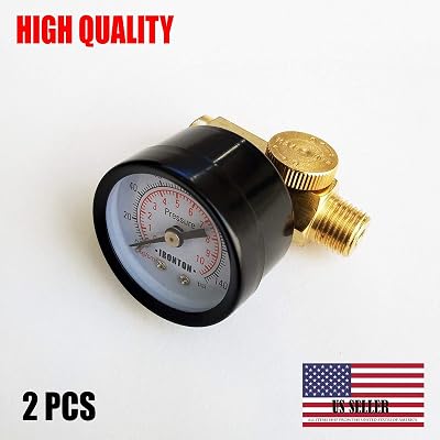

Yes, a regulator right at the tool would make a world of difference in controllability. Something like what you'd use on a HVLP spray gun. But it's got to be a REAL regulator, and not one of those variable flow valves.
This, for instance is NOT a regulator, so don't be fooled by this ****:
This is, and would be just the ticket:
https://www.harborfreight.com/150-psi-air-compressor-regulator-kit-with-dial-gauge-68223.html
There are some really nice inline options too:
https://www.amazon.com/dp/B008ZE1Q7Y/?tag=atomicindus08-20
