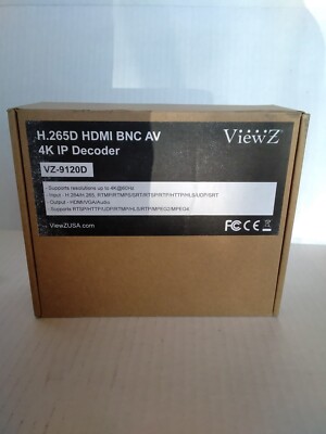

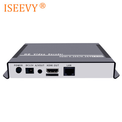

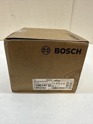

A standalone H264/H265 decoder will work. You just have to find one that is a good buy. There are some Chinese options as well but I haven't played around with them. I've used the Bosch.

if the latter, and they are ONVIF you can use an IP decoder with HDMI output to connect to a monitor

If you want to display the cams on a secondary screen you can get an IP decoder. The cams would need to be ONVIF compatible if they arent the same brand as the decoder.
