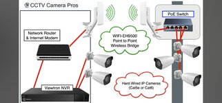

I use a pair of tp link 2.4/5 ghz antennas between my house and shop. Inside the shop I have a tp link Jetstream omada switch which has my reolink poe switch in there plugged into it. I also have a tp link omada wall mount wifi access point.
Here's my omada topology
54275373465_f2fb103af4_c.jpgScreenshot_20250119_075047_Omada by NakeDiesel, on Flickr
