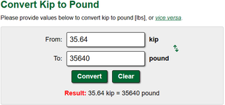

But the AI Bot confused inches and feet ?
That is a little confusing and it's my fault because I didn't specify 1/8 inches in my question.
I changed the question to include inches and the AI spit this out:
Calculating Point Load
To find the point load for a simply supported 14’ long W12x19 beam allowing 1/8” deflection, we need to solve the deflection equation for the point load (P).
P = (16W^2) / L (d / (5/384) (EI))
Substituting the given values:
  • W = 12 inches
  • L = 168 inches
  • d = 1/8 inch (0.125 inch)
  • E = 29,000 ksi
  • I = 368 in^4
P = (16 (12)^2) / 168 (0.125 / (5/384) (29,000 368))
P = 35.64 kips
Thus, the point load for a simply supported 14’ long W12x19 beam allowing 1/8” deflection is approximately 35.64 kips.
I don't know what kips is but an online calculator shows this:
A completely different answer than the first time. Probably neither one is correct (15 tons! There has to be an error somewhere) and underscores the fact that these are not real calculations by real engineers who understand the specifics.

A W12x19 with a laterally unbraced length of 14' (distance between support columns) can support its own weight plus a 196lb concentrated load at midspan. So basically if an adult male hung from the beam at midspan, it would have no additional capacity to hold anything else with that 14' unbraced length between columns. so more than a bird, far less than a 1000lbs and not even laughably close to 35.64kips.
gsmith22
Jul 14, 2015
337
Central NJ
and just to show how flange width matters for long unbraced legths of the compression flange, taking a W12x40 (12" deep, 8" wide flanges) with an unbraced length of 14' can support its own weight (40lb/ft) plus a 2,267lb concentrated load at midspan. yes, the beam weight went up because there is more material, but the distribtuion of that material mostly to the flange width helped dramatically with overcoming the lateral unbraced length of the compression flange between supports. which is why adding that channel at the top flange is a common way to build up a member that supports overhead crane rails where the support beams cannot be braced except at the supports (columns at 14' in this case)
