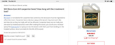

no harm in searching what controls them. maybe boracare? Easy enough to apply pre build.

I've had carpenter bees bore into PT wood, I was surprised. Can't remember if it was AC2 or CCA.
