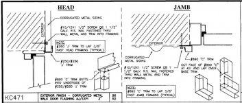

I did some googling and didn't find any examples.
I need to install a vinyl slider in a pre-existing pole barn and make it look nice with flashing.
Thoughts?
I have access to the sheetmetal form the inside, I can pull that OSB off. I want to put it somewhere between those two posts.

I am guessing it's not a window made specifically for a steel sided barn. Those don't require any flashing. They're a bit spendy, but they look nice. I posted some photo's below.
So if it is a regular house style window I would suggest framing it with bookshelf girts (see next post for a detail) and trimming it like a man door with "J" Trim at the top and "C" trim along the sides and bottom (see detail below)
