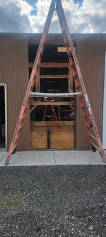

Hoping someone can help, I have 3 of these windows in my shop that need to be replaced - what and how is the best way to do this?

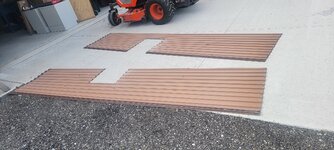

Well, I'm into it now, pulled the steel - surprisingly tough with 50+ yr old nails
found the wood around the old window to be in really poor shape and not well secured

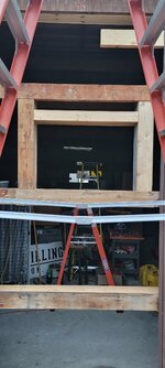

Started framing back
Bought an economical window from Duo-Corp via Amazon, mostly because it had integrated J-Channel first one arrived with the nailing flange broken
And ReGrip Screws from Jakes Sales also via Amazon - specifically for replacing nails, oversize washers
Hoping to get window installed and steel back up both with a healthy dose of Lexel this weekend

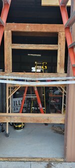

Got the rest of the framing in
Went slightly bigger, old window was 18x36 new is 24x36. Unfortunately no in progress shots as I was fighting caulking and "sliding" the steel back into position.
I've got a couple more screws to put in but calling this done,
