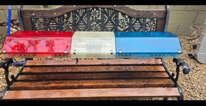

I have a Code 3 Excalibur lightbar and I want to mount it in the garage and wire it to use a wall outlet
How and what do I need to do to get that working thanks

Been there, done that. Just need a 120VAC to 12VDC power source with enough amperage to handle the load.
FYI: Although it will be perfectly legal, as it would not be mounted on a moving vehicle, be prepared for unexpected attention from your local LEOs. It WILL draw their attention, and some LEOs are funny about ANYTHING that appears to imitate or usurp their authority.
I took mine down soon after the novelty wore off.
