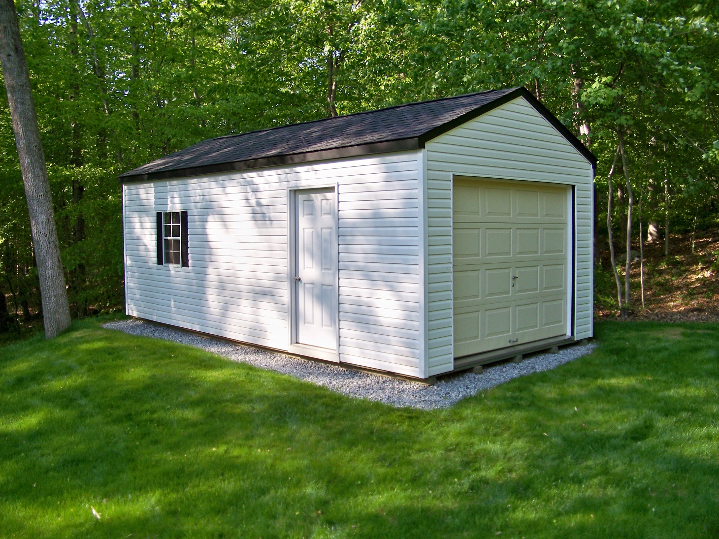

I purchased a used prefab 12 x 24 shed/garage with 8’ walls from sheds unlimited for $3800 which is less than half the price of a new one (+$1400 for delivery from PA to CT). I'll post pics later. I was going to build it myself, but this deal was too good to pass up. This is a shed they used for 2 years. The 5/8” plywood floor was pretty dirty, so I decided to put a second 5/8” underlayment plywood over it.
Shed is sitting on gravel with typical 4x4 skids. I've had to partially block off the space between the 4x4 skids to keep the groundhogs and foxes out. There's still some air flow.
Purpose of shed/garage is general and lawn equipment storage (lawn tractors, log splitter, string trimmer, cement mixer …). Since some of these are likely to leak a little oil or hydraulic fluid, I was thinking it might be a good idea to throw some polyurethane on the plywood to offer some protection from misc fluid drips. Only concern is whether putting poly on there is more likely to shorten the floors life due to potentially trapping moisture.

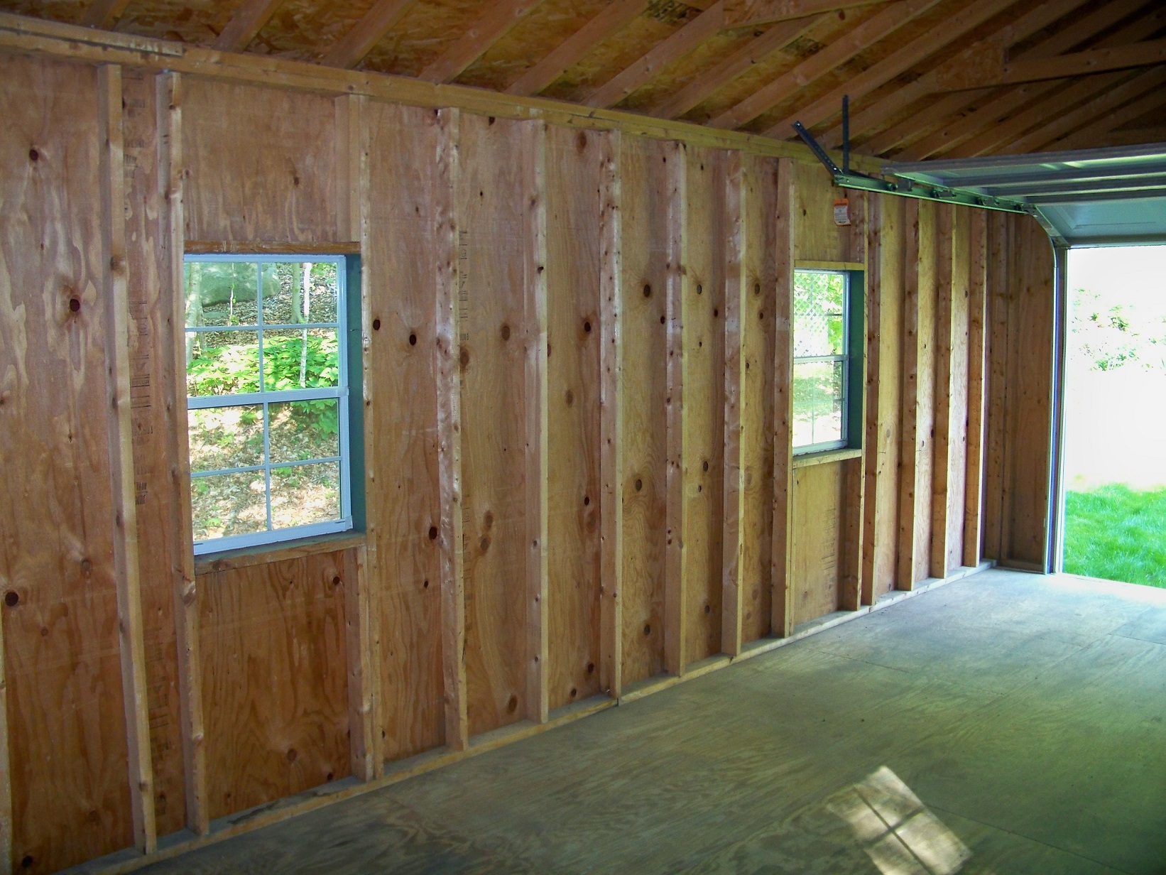

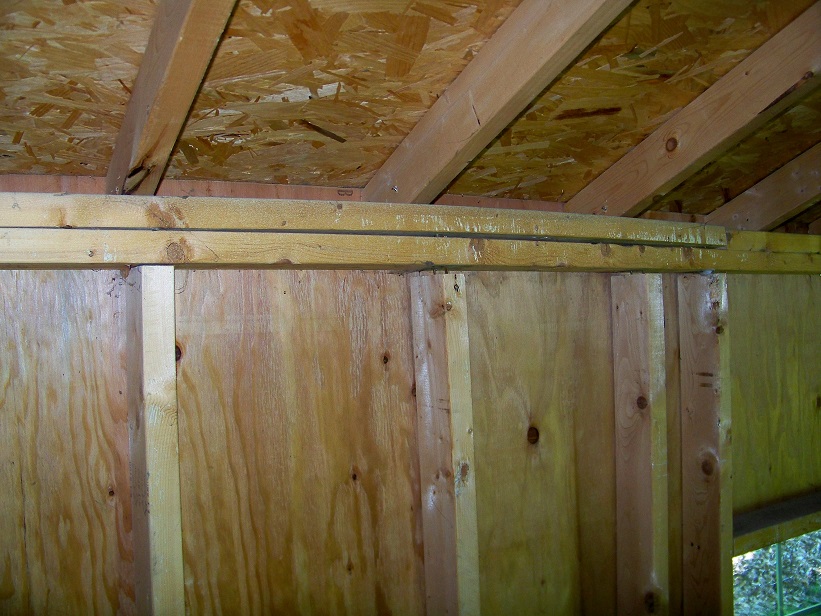

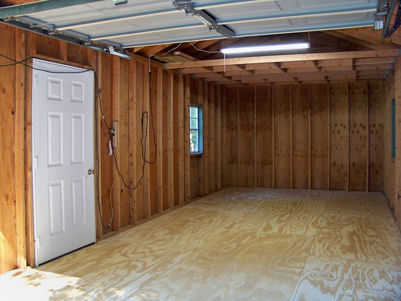

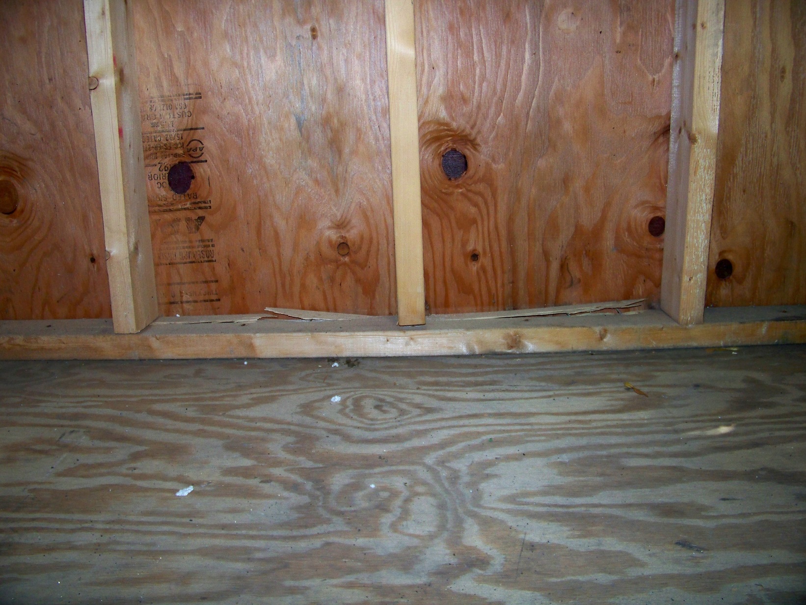

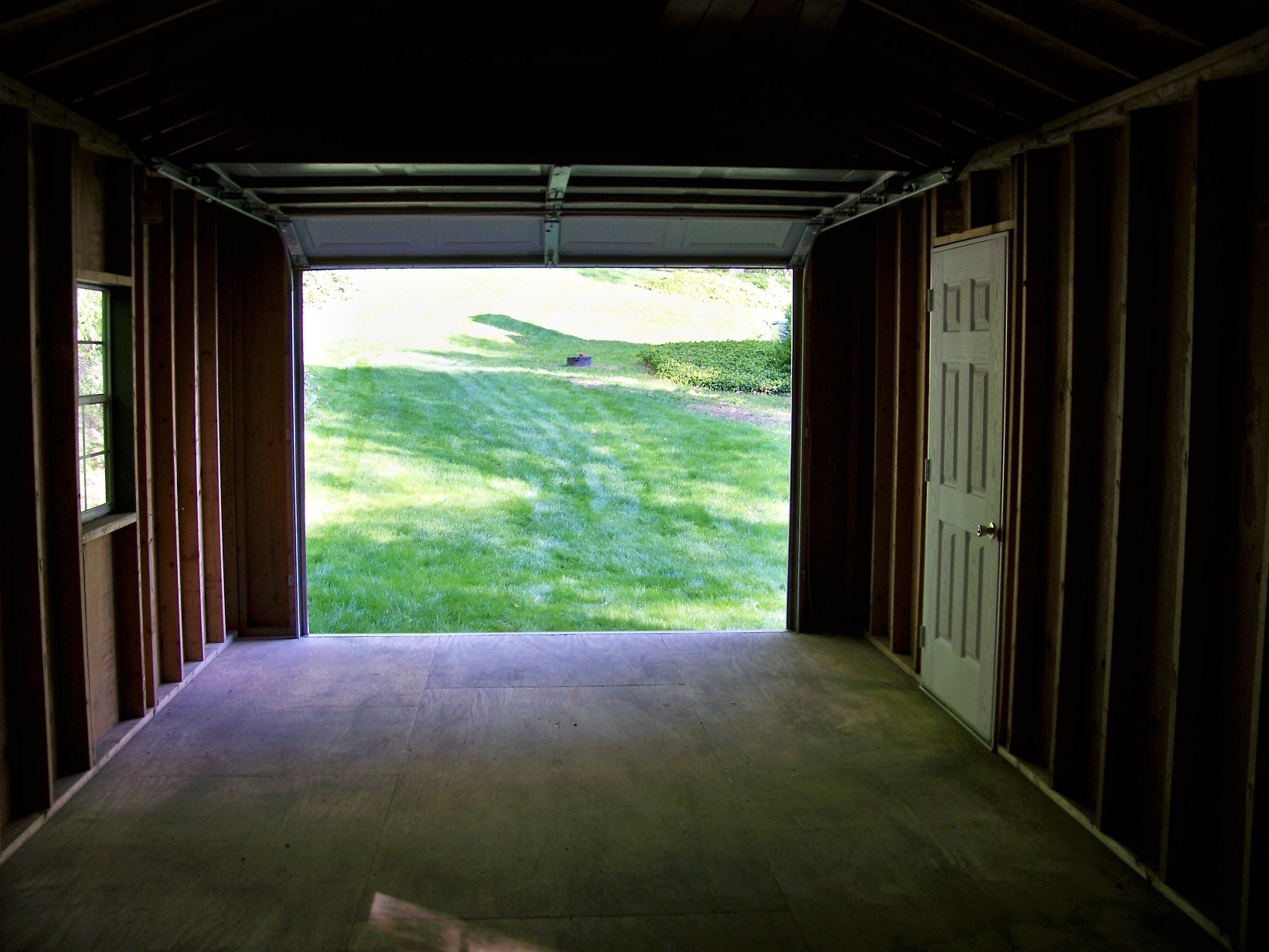

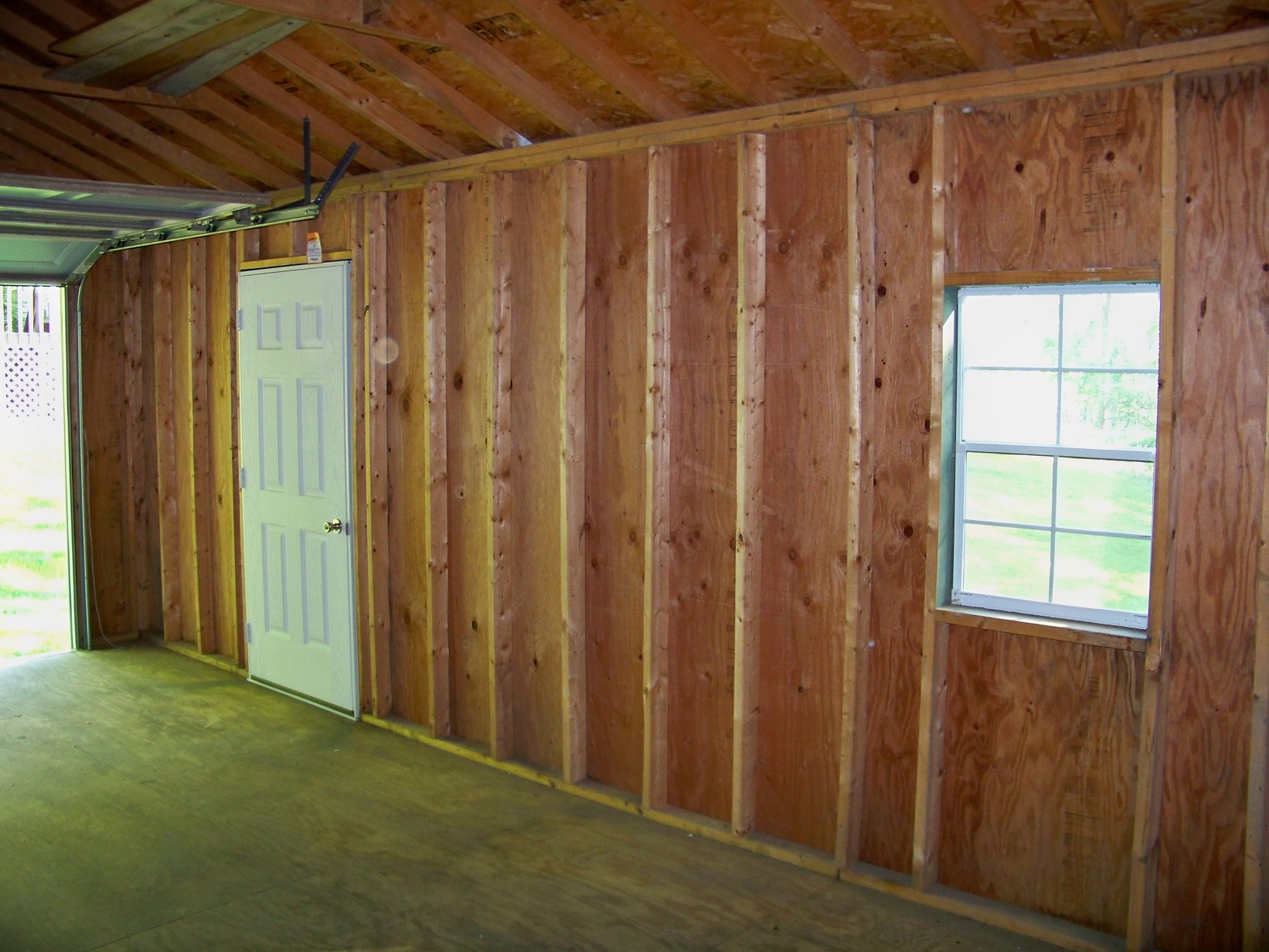

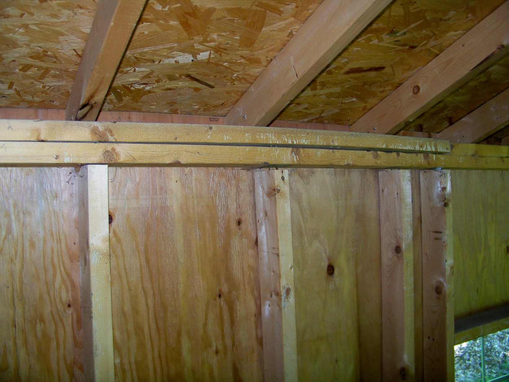

I’d say you got a good deal. Nice shed. Please post some pics of the inside.

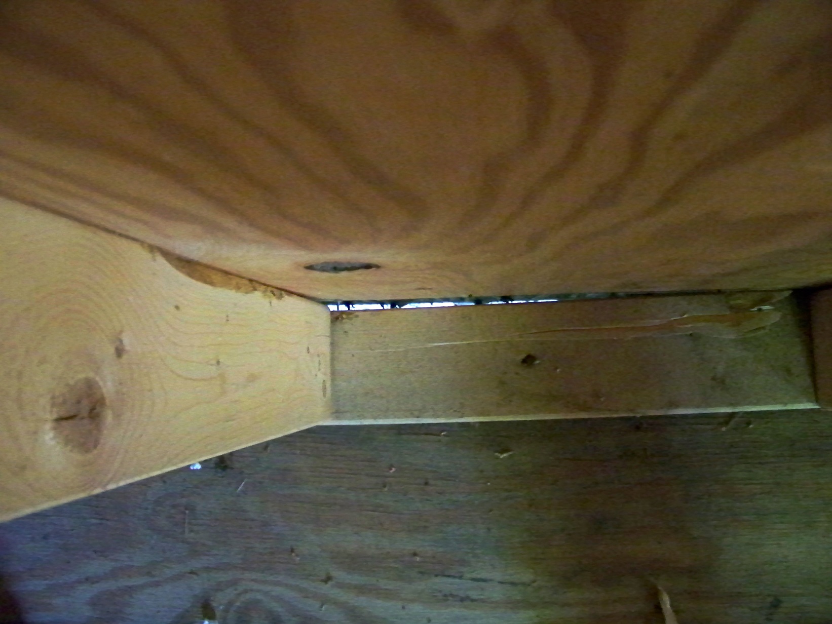

They're not the best pics, but here you go. These are before I installed the second layer of plywood. I haven't taken pics of that yet.
(as always - click pics for larger view)
There was some damage that I have since band-aided. Need it to be mouse proof. Considering the price, I'm not complaining.

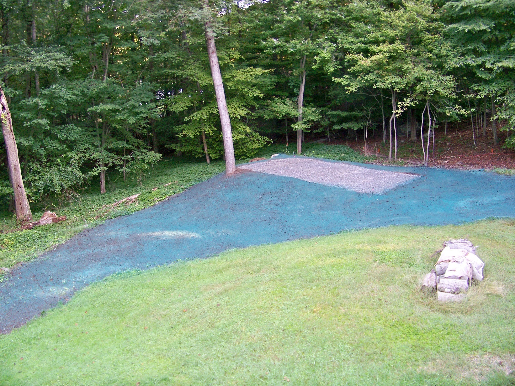

homelessdespot - Shed company does not do the pad. My pad construction is a rather long painful story - (in brief) I live on a hill. El Cheapo Contractor #1 made a pad that was out of level by over 2ft -took 2 months to not finish the job and didn't respond to any contact attempts. Contractor #2 did an incredible job - 3 guys 12 hrs 1 day - started at 7 AM and was hydroseeding by 7 PM. Cost for Contractor #2 = $5400. Contractor #2 owns the local gravel and fill place.
This is Connecticut - though exact requirements vary by town, you likely do need a permit. I had to get 3 approvals/permits:
1st ($100) from health district to make sure it wasn't too close to septic or leach field.
2nd ($85) from Zoning who I provided a drawing showing structure was within all setbacks.
3rd ($51) (price is a calculated percentage of shed cost) from building dept who provided the actual posted permit and inspection. Building permit is required here in OS for any structure over 200 sq.ft.
https://shedsunlimited.net/ is very low cost even after shipping.

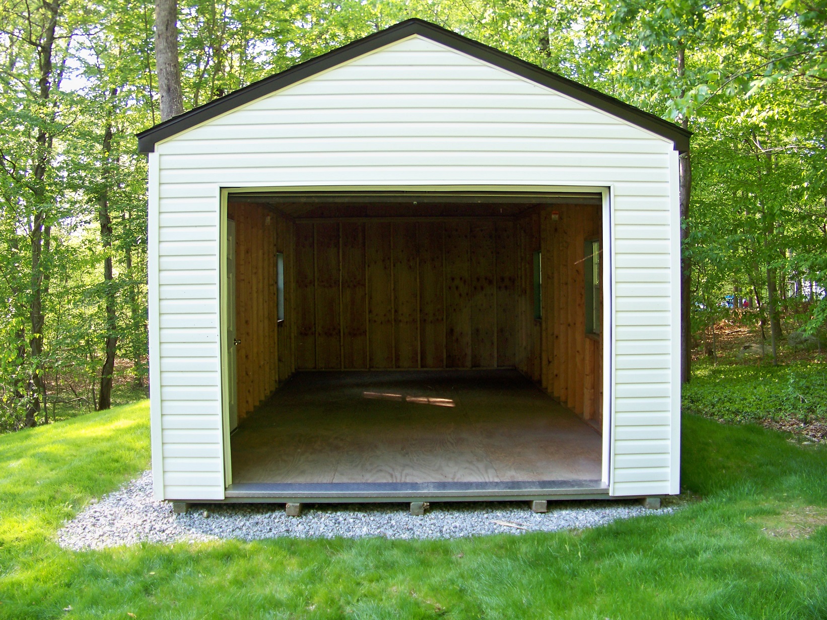

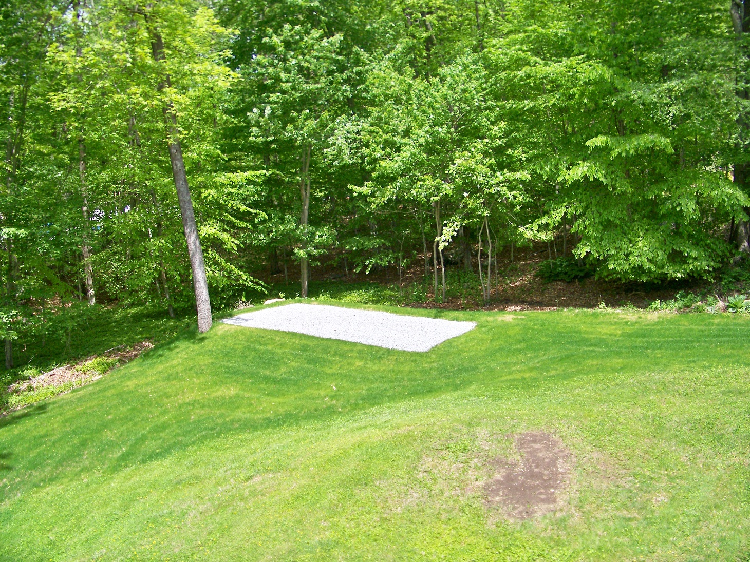

Here are before and after shed pad pics:
P
Platonic Solid
Nov 29, 2014
3,587
CT-USA

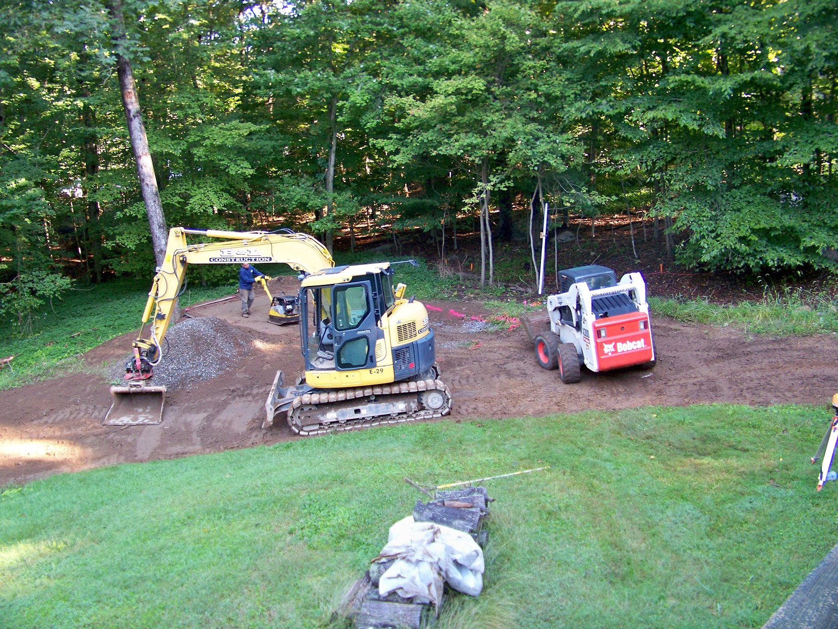

These 2 pictures of Contractor #2 give you an idea of what was involved with my shed pad. Yours may be significantly cheaper if you have easy access and a level property.
homelessdespot
Oct 25, 2018
260
CT
Thanks Platonic, they did a real nice job. That gives me a much better understanding of process and cost. Trying my hardest to find a house to buy with 1-2 car garage, but may have to have shed or garage built if I find one without that I can't pass up with level land.

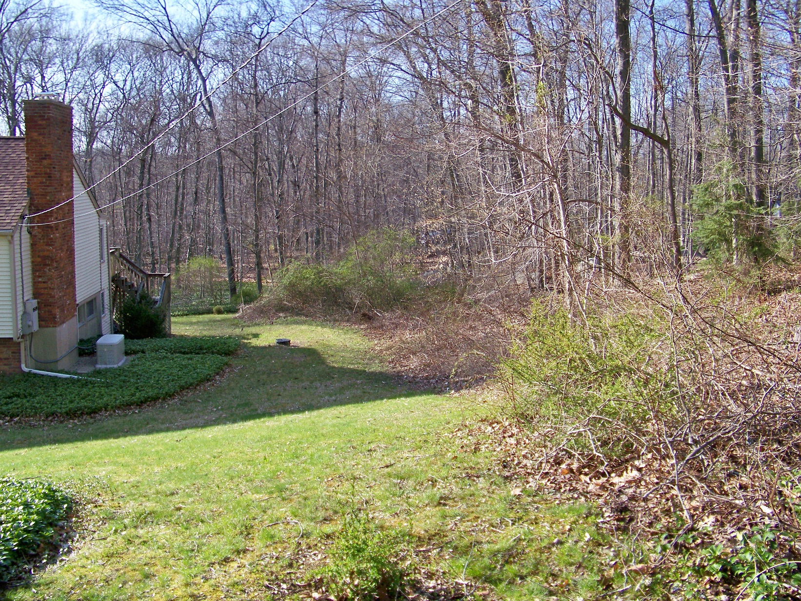

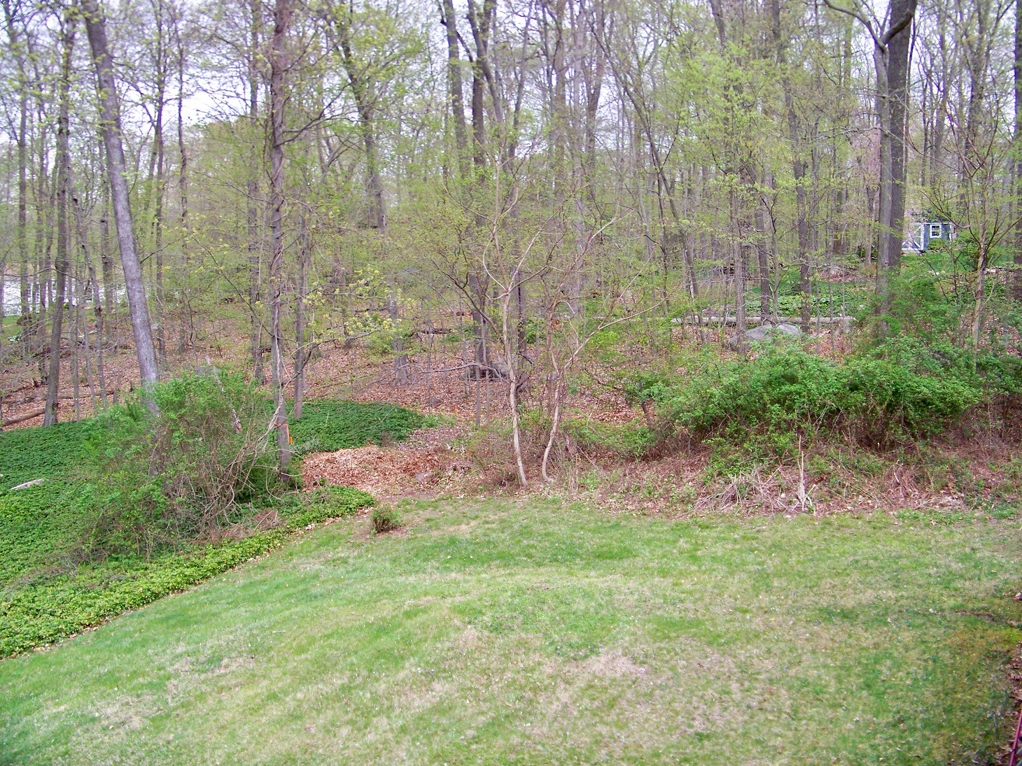

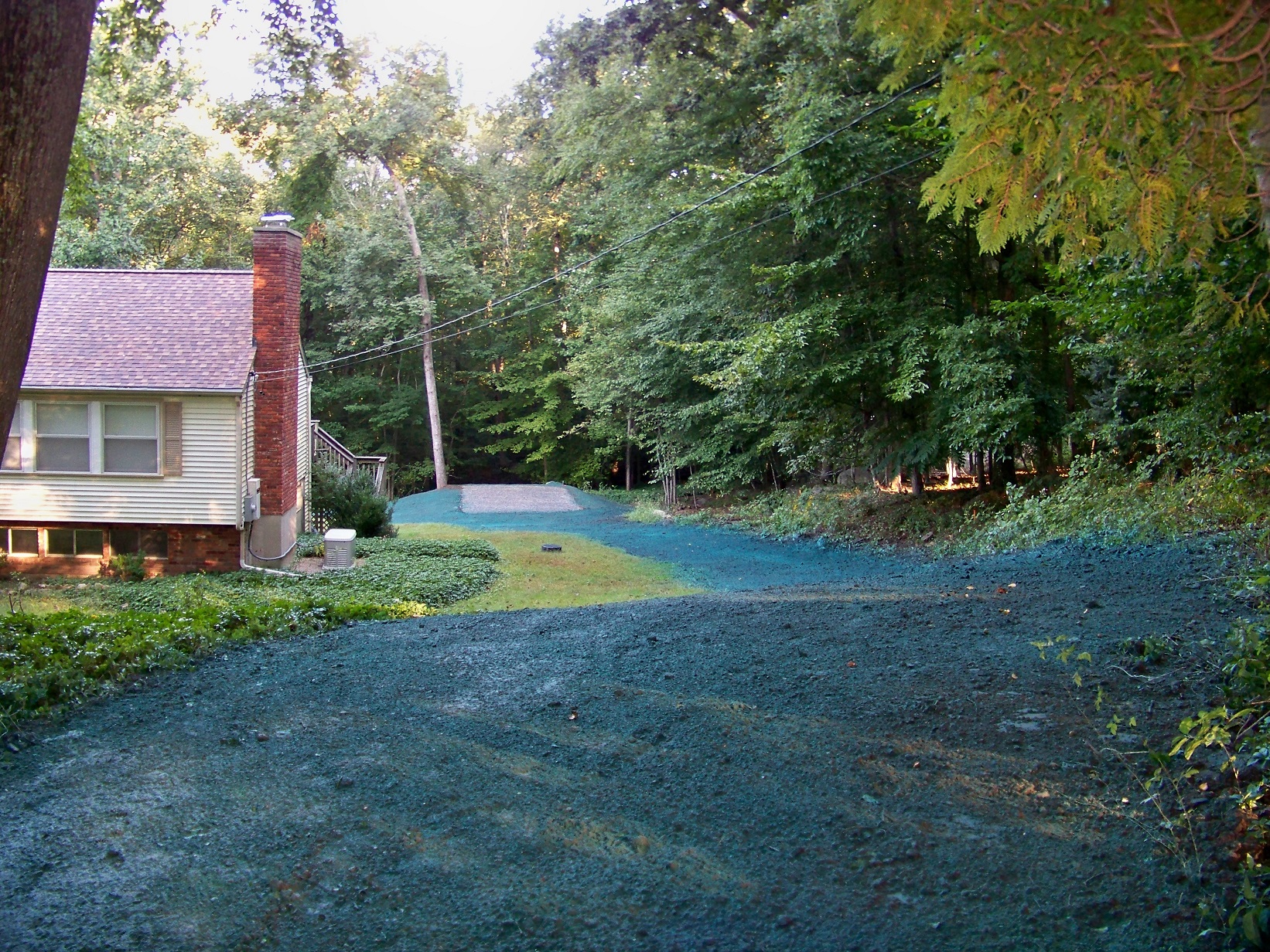

Here is another before and after shed pad shot to better understand the ha$$les involved with living on a hill:
All material had to be dumped at the top and skid steered down to the pad.
homelessdespot
Oct 25, 2018
260
CT
Oh wow, you weren't kidding about hilly, that's a lot of seed and repair just for the path back there.

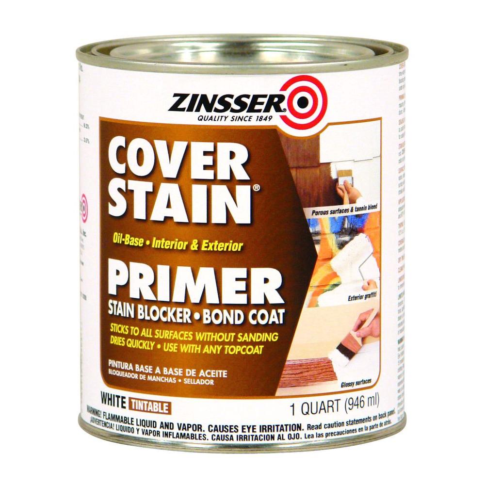

Just came back from the paint store with 2 gallons of DRYLOK Platinum E1 Epoxy Floor Paint (link to mfr website) and 1.5 Gallons of Zinsser Cover Stain White Oil-Based Interior/Exterior Primer and Sealer (had to buy the primer in 1 quart containers as the 1 Gal. size is no longer allowed in CT). The guy at the paint store seems to know his stuff and this is what he recommended for my application.

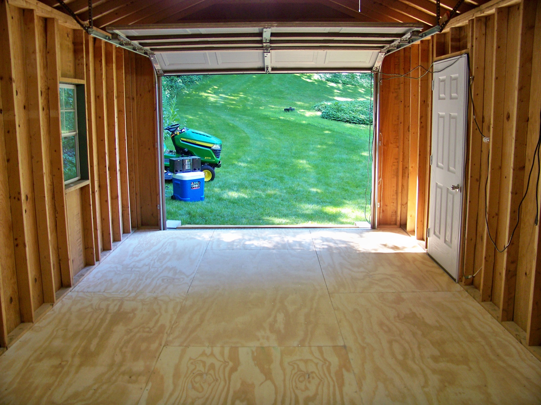

Happy 4th all!

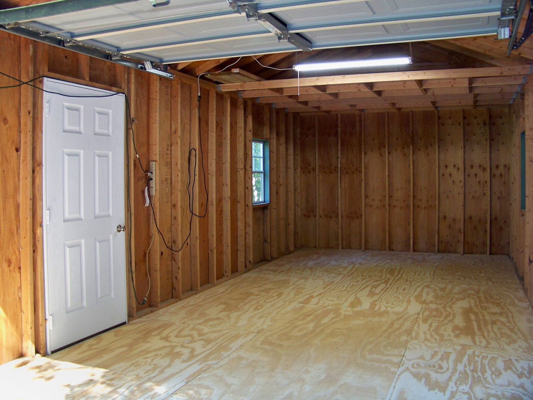

Finished putting new plywood on floor and added a small attic space to store longer 10' to 12' items that I never seem to have a good place for.

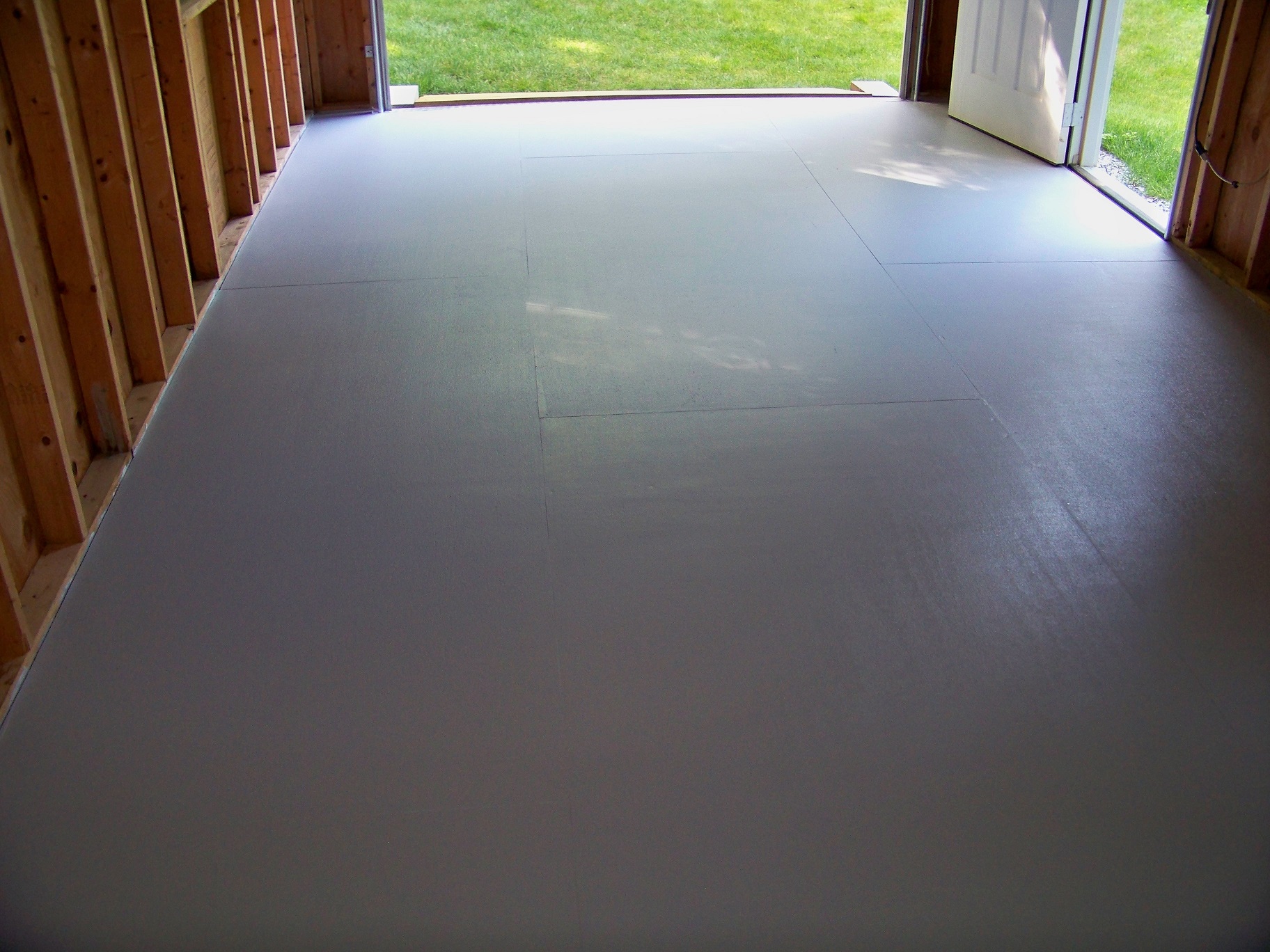

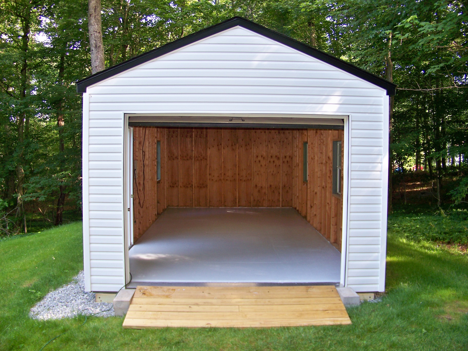

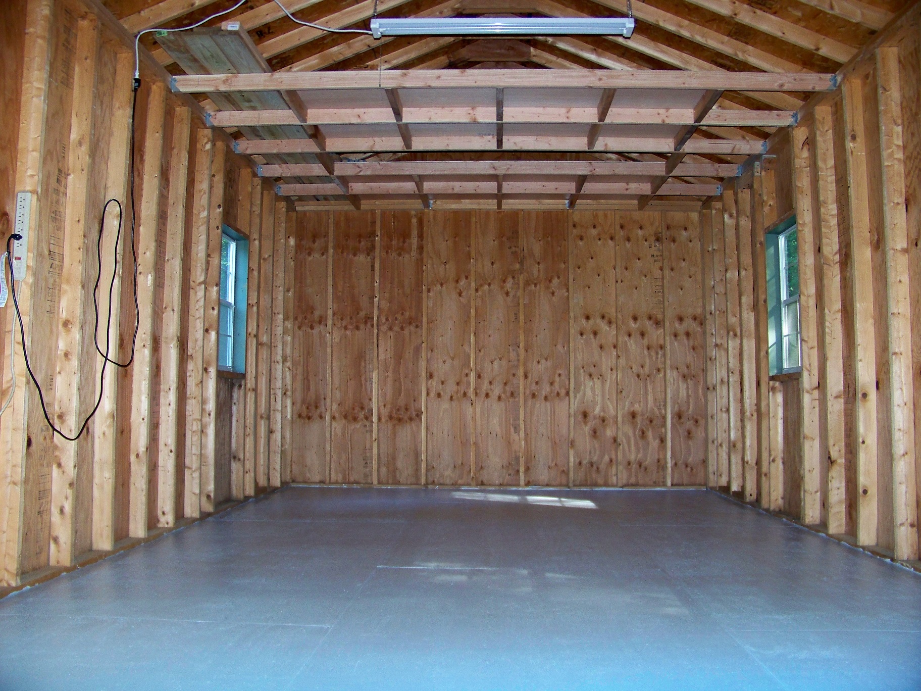

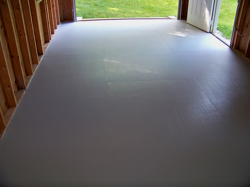

Finished priming and painting the floor. Took 5 quarts of primer for one coat and 1 gallon of the floor paint for 2 coats. I returned the 2nd unused gallon. Instructions state not to apply more than 2 coats.

Looks good. Garage Journal strikes again! I would have never considered finishing the floor in my shed. Now I question how I have lived like this all these years. :)

Looks good. May already be on your list, but I would install some metal trim at the entry to protect that edge and it might be worth raising the ramp to meet the floor better, if you'll be rolling stuff in and out much

bad_idea - We'll see how well this holds up. The primer states "not recommended for floors" and the chemical resistant paint only has instructions for cement application - makes no mention of wood, but does mention previously painted surfaces. It definitely made it easier to sweep and makes it feel less like a shed and more like a garage.
mike93lx - The shed came with a diamond plate threshold. I had to cut my new plywood layer short of the threshold to prevent garage door interference. I rounded the edges of the plywood in that area with a rotary sander.
The ramp may be a bit stubby, but the lawn tractor clears it. I built it with leftover PT lumber from the rat-shack project. The ground outside the shed briefly slopes up, which permits a shorter ramp. I plan on digging out the lawn in that area and laying a bed of gravel for improved drainage so the ramp lasts longer.
