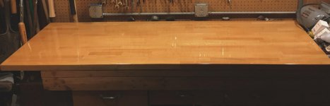

I would do an epoxy coating. The stuff is indestructible when it comes to fluids. its 1/8" or so thick depending on how thick you apply it. Its self leveling and it will remain glossy but will end up with fine scratches after tons of use that can be wet sanded/buffed out.
I will never go back to an oil or poly finish on a wood work surface. Pick your color of stain, then epoxy coat it. I chose gloss for this one and after 2 years and very happy with the results and durability. It is available in satin also. you can see where a bug got into the epoxy in the first pic and the approximate 1/8" thick.
Looks very nice. Personally, I have never worked with this. My brother in law did a live edge "coffee" table for his bride and imbedded shells from the shore in the valleys between the pieces of wood. Needless to say, he poured his. Just wondering how you do the edges..... Can you brush this on if you don't need it to be 2"-3" thick?
AngryBeaver
Jul 12, 2017
1,705
Lake Milton Ohio
that is what I did. I taped the bottom so it wouldn't run under the bottom. brushed it on with a foam roller at first, then switched to a brush. there is a strand or two stuck under it that I didn't see until it was too late. Use lots of cardboard on the floor for drippings... there is still remnants on the floor two years later

Epoxy is cool, and very durable but expensive and the application process has a steep learning curve. Plus, all flaws are very noticeable and very permanent.
Wipe on poly is great, easy, and cheap. European hardening waxes ie Rubio, Woca, etc... are super easy to apply, look great, can reapply easily, but not as robust and $$. Tung oil and BLO are similar but even less robust.
Personally, I think the wipe on poly is the way to go. Nice stress free application, fairly strong top coat, easy enough to refinish, cheap, and looks great.
I would disagree. the kit was 40 bucks at lowes or home depot. No special learning curve. goes on like a thick paint.
