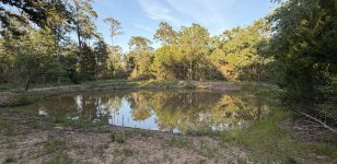

We must have received more rain that the nearest weather station reflects. I’m close to full. Hasn’t challenged the spillway yet.
Next steps, get some mosquito control fish in there. And maybe some crawfish. And some plants.
It’s pretty small. What would you stock this with? More for a healthy ecosystem than sport fishing.
Aeration is going to be a problem given how far electric is. Solar maybe. Or run an air line from the place where I have electricity.
I’ll figure out how to get the jeep out later.

Does your area have a stocking program ??,,,,,they could tell you better,,,,,,nice pond !!

I’ll check with the ag service. Not finding a lot of fisheries in area.
And thanks.
Be nice to find a way to run a small bubble using shore mounted solar panel voltage. Not sure if that‘s a thing.

Looks nice.
That a pretty small pond, so you might be dealing with water that gets pretty warm in summer, even if aerated..
Maybe start with bluegill?
God luck.

Windmill powered aerators are an option
Torque&Recoil
Dec 13, 2015
438
NE Ohio
We have some white amur to help to keep down vegetation. They are sterile and can't reproduce.
Aeration would be good. I should do that to our pond. Not sure about solar, but I have seen little "windmill" type air pumps. (dang, JeepYJ beat me to it)

A lot of the ponds here use windmill driving air pumps as aerators as shown above
Also a lot of people here throw a few rye bales of hay into the pond (whole) every so often to keep algae at bay
How far away is that? Is it not too hard to trench that far? The required pressure for your air blower is dictated by the water depth. My little koi pond is only 2 feet deep so an off the shelf small pond blower pump works fine.
Guessing about 1/4 mile. I was thinking 1/4” PE tubing. Run it down the creek bed. Would never see it.
I don’t think that will work very well because of the big pressure drop from internal resistance with such a long length of skinny 1/4 inch tubing.
That’s a big pond to aerate. You’ll likely need multiple bubbler heads requiring several CFM each. Better talk to a pro designer.
I run about 20 feet of half inch PVC from the blower to the pond and then about 6 feet of 1/4 inch tubing from the edge of the pond to the bubbler head.
