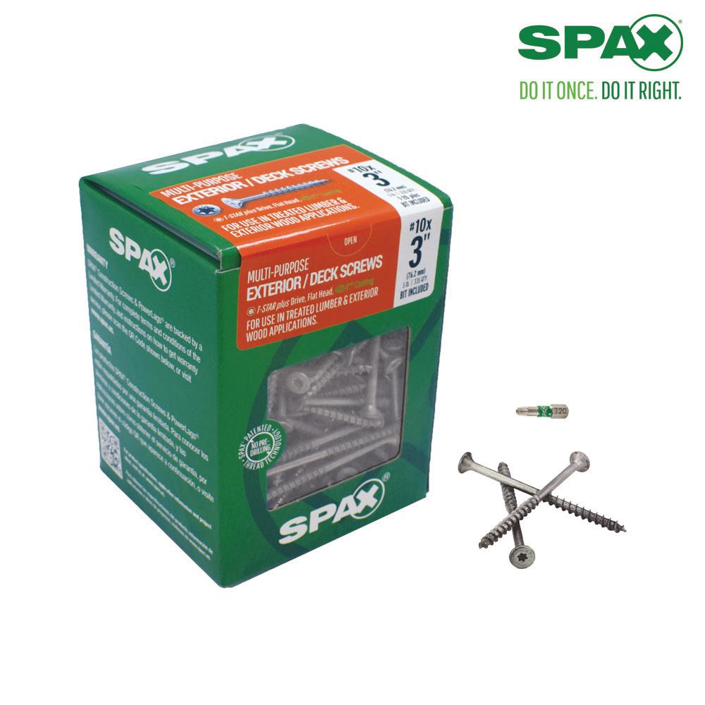

2-1/2" or 3" deck board screws?
Likely will go with a coated version, stainless is too expensive
cj7jeep81
Jul 11, 2006
463
S.E. Indiana
If using 5/4 decking, I'd use 2.5". If using 2x decking, 3". I would recommend getting ones that use a torx bit. Square drive or philips strip way too much.
I would highly recommend stainless steel. We built our deck when they were switching over to the new treated lumber and were not aware of the corrosive nature of the new wood. Below is a picture of the screws I had to remove to replace a deck board. Some of the coated screws were so bad there was only small needle of a screw left. Because our deck is older I have switched over to galvanized nails when replacing a board, but if I was building a new deck I would recommend investing in stainless steel fasteners.
Our deck is next to a pool and I believe the chlorine plays a part in the corrosion as well.
Simpson Strong Tie has a white paper out on how to protect connectors from contact with new treated lumber to prevent corrosion. http://www.strongtie.com.au/pdf/tech_bulls/T-PTBARRIER08-R.pdf

Grip-Rite #10 x 3 in. Stainless Steel Deck Screw
322 screw
Star drive head
$56.58
Deck Mate #9 x 3 in. Star Flat-Head Wood Deck Screw
#365 screws
Star drive head
$23.78
CKS1955
Oct 12, 2014
489
The screws in my post above were Deck Mate screws.
I would go with the Grip-Rite stainless steel.
Jay

Those look nice but wow they are pricey
Did you have to predrill at all, when using #10s? They are stout for sure, but I also worry about splitting

#10 x 3" stainless deck screws are $44 for a 5 pound box......
#9 x 3" triple coated deck scres are only $23 For a 5 pound box.
Both have a lifetime guarantee. I went with the triple coated....T25 6 point drive head also
CKS1955
Oct 12, 2014
489
I hope they perform for you, mine certainly did not. Remember chlorine is also corrosive in addition to the treated lumber.
