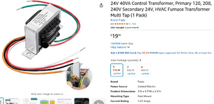

For version 1.0, I used a transformer and a contact inside the heater housing along with a timer on the 24 V circuit. All worked well for a year of occasional use in the garage so a wild guess is 200 to 1000 hours. It started to smell for a few days and then quit. Multiple wires were burnt at the connectors, some were my crimps and some the OEM. The heater was 13 years old. All of the individual components looked OK. I even cut open the transformer to see if it looked OK inside and it did. I don't have any spec on the heating coil to test resistance. Since I don't know the failure mode and have no experience with things like this I suspect that maybe one of my crimps failed so would like to stay away from something that requires me to crimp on connectors. Any guesses at failure mode would be appreciated. I just bought a new heater but would still like a timer.
