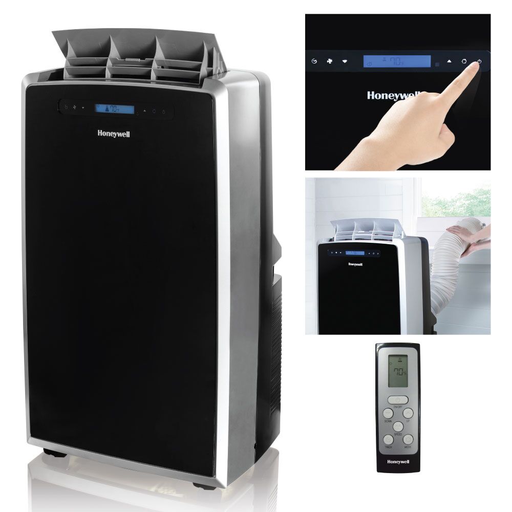

Anyone with experience with something like this? Planning on a mini-split at some point, but thought this might be a stop-gap until I can get the 220v run. Or am I just wasting $550? 750sf garage in Phoenix, AZ. Doors are insulated now, attic and walls are not, but will be by next spring. I don't expect to keep the garage 70 degrees, but below 90 would be nice in the summer. Many days it's over 110 in the garage during the summer months now.
https://www.walmart.com/ip/Honeywel...t-with-Dehumidifier-Fan-Black-Silver/23091461

I haven't used one, but have considered one.
Two things:
1) You need to vent them to the outside (heat has to go somewhere)
2) They produce condensation, so you either empty the pan or need a drain.
AZ is pretty hot - might need two of em, what is the BTU rating?

I have the vent issue taken care of and I can deal with the drain. It's a 14k unit. Just not sure how well it will work when the intake air is over 100? Kinda seems like these are meant for cooling down a room in a house that's already air conditioned, just can't keep up situation?

Been a couple threads about them recently. General opinion is they work to an extent but are far less efficient than a window unit

The three hose units are HORRIBLY inefficient. Four hoses are much better, but are very noisy.
I say they’re a waste of money.

I'm also in Arizona. It will work fine.
If you want to cool a 5x5 space.
Super inefficient
Save your money for a mini split

Sounds like I should just hold out for the mini-split. Guess I better get the 220v run before next spring. Thanks all for the feedback.

The two hose units are decent. The single hose are universally **** - they HAVE to pull in makeup warm air from somewhere - and it isn't the exhaust hose.
Everyone I've met with a two hose unit that complains hasn't installed it correctly. Either they haven't sealed around the window, or they install it with the hot air hose on the bottom, or they put the small hose for the intake and large for the exhaust.
I have a 11k dual hose that works about as well as a 8k window unit. I also have two 10k windows units that both work much better than the 11k. I have a single hose unit that I use at work. All **** compared to central AC - YMMV.

The single hose units are a complete joke, and I don't even know why the EPA allows them to be sold. They pump their hot air outside through the hose, but every cubic foot of air they pump out of the house means a cubic foot of hot humid outside air has to leak back in to the house somewhere. They can typically cool one room down at the expense of making the rest of the house hotter.
The two hose units are better, but are often poorly designed and don't work as well as they should. It utterly baffles me why these things are apparently impossible to get right.

Well I have this unit and yea it makes a lot of noise but it cools down our second story master bedroom that is 19 x 15 and that is with 4 German shepherds in with us. I did put in a 5 inch copper vent just for this type of unit.We keep at 66 and works fine.
