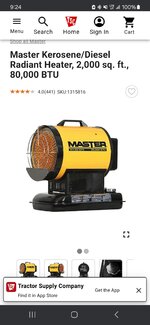

Heater the type of heater I have in mind
I have a similar one to that.
Good to warm a larger area continuously, but in smaller spaces, you have to turn it on and off all the time, kind of a pain
To my knowledge they can’t be configured to use a plug in thermostat since there is no way shut off the gas flow other than manually
