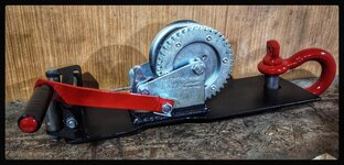

I think OP wound up looking for something that could be 12 volt powered as well as hand cranked, but since he was originally contemplating a drill winch, I thought I would post my little project.
I used a worm drive hand winch, welded the nut to the shaft, then fabbed some plates I bolted through the base of the chassis to give me a place to connect hooks/shackles.
Now I can use a drill with a socket adapter to drive it, but I left enough threads that I can still use the handle that came with it as well. That said, the gear reduction with the worm drive is like 40:1 so it's slooooow to crank by hand. The drill in high speed is much more useful for simply taking up slack.
I have a 50' Amsteel Atv winch line I might swap in for the cable. That would make it even lighter and extend the reach. At the end of the day it's a very compact manual/drill winch with 2000lb single line capacity for not much money.
