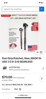

Made in USA, lifetime warranty, gearless ratchets.
Sold on eBay for a fairly reasonable price.
They get good reviews.
Anyone here have any experience with them?

I have an older Kobalt ratchet that is very similar to this. I don't use it often, but it has come in handy for very tight areas. I can't remember if it is made in the USA, but the mechanism is probably similar.

I have at least one of this style in a Kobalt and another in either a Snap On or Mac/MATCO (can't remember), and back drag is fairly noticeable. I need to dig them out, but none of them ever made it into any of the regular ratchet rotation in any of my shops or truck.

The handle/head shape is strongly reminiscent of the Taiwan Sears tri-wonga that we're not rebuildable. However, those were not a gearless design.

I had one of these some while back, and they're much less useful than you'd think. I don't even remember what I did with mine; probably donated it somewhere.
1) The heads are really big and fat. When you're in a limited access situation that's the last thing you need.
2) They often get sort of "stuck"; it's not so much back drag, it's that the mechanism inside (a ball and ramp thing, IIRC) can be a little sticky so they often don't release easily when you turn the other way. I used to have a "ratchetless" screwdriver that worked on the same principle, and had the same problem. Absolutely maddening in use.
I think these were a more useful option back when ratchets were all chonky 36 tooth beasts.
Any 72+ tooth current ratchet with a reasonably slim head is going to work a lot better, IMHO.

Double checking, are you saying you had a gearless ratchet of some sort or are you saying you had the gearless ratchet pictured above?

The example posted "can take 300-500 LBS torque":rolleyes:
I have a seldom used gearless thumb ratchet. Works well enough and is truly zero or damn near backlash, for lack of a better term.
If you find yourself working in impossibly tight quarters these are useful otherwise,, eh.

If the gearless ratchet is superior to the gear ratchet in super tight quarters due to being more efficient and having less wasted "swing," why would the gearless ratchet become inferior when not in tight quarters? Wouldn't the gearless ratchet be better when there is plenty of room too? Because at that point, you swing less to turn more, which is helpful in tight quarters and not so tight quarters. Right?

I didn't say inferior.
According to others this style has significant backdrag (which could significantly mitigate their benefit), are bulkier and prone to jamming.
Mine gets so little use I can't even comment other than it is a one trick pony. By design it is not reversible so the driven tools need to be detached and the drive square pushed through to the other side.
Buy it and try it, I'm curious.
Mine is same as this; https://www.ebay.com/itm/226157475925
This discussion made me curious so I got mine and agree it has significant backdrag. No big deal unless the fastener being worked is quite free. I don't recall it ever jamming up.

I don't remember what brand it was, but it looked identical. I had a 3/8" drive version. It's been some years.
The 1/2" drive doesn't seem all that useful; maybe try a 3/8" (or 1/4" drive if they have one) and see what you think of the concept?

Gearless ratchets like that have some advantages - very low arc swing (they say "zero" degrees, but clearly that doesn't make sense) and strength. However, they're bulky and can have quite a bit of backdrag.
Do the benefits outweigh the downsides? That's on you to decide.

I could see adding a gearless ratchet for yet another option. However, I don't think I'd want it as my daily-driver. Too much bulk and backdrag.
