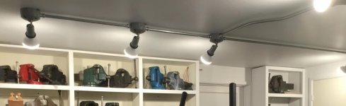

It’s not over a workbench, but I also use those outdoor floodlight holders in my basement room where I have built in shelves holding my bench vise collection.
