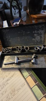

Took a chance on a FB market place for a Thorsen set. Not many of originals left but did get a S-K ratchet and Breaker Bar from so..20250915_220814.jpgThe label from the box.
The treasures from the box and a few socket lots of brands. I wound upwith 2 each of 1/2" and 9/16" swivel. Lots of other brands such as Craftsman and KAL Japan
I did get a S-K ratchet and Breaker Bar both 3/8".

The Ratchet is unmarked but consistent with what I've seen for other Thorsen units.
Also did get some Giller stuff which I am given was a tool provided to the Military.
If you can help me confirm that the flex head is a Thorsen it would be appreciated.

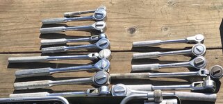

I don’t believe that your flex head ratchet is Thorsen. All of the Thorsen ratchets I have are marked.IMG_8496.jpeg

@2001ZR2 - no, that flex-head unit is not Thorsen - at least not U.S. made Thorsen, anyway.
Thorsen's 3/8" drive flex-head ratchet was the 77NR model:
Thorsen 77NR 3.8 dr flex-head ratchet 040124
Yours might be a later offshore-produced "Thorsen II", but without a stamp it's hard to say.

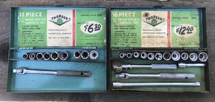

ITCL has a 1975 catalog. It's different labeling and motto. But again only lists a 1411 and 1416 sets. Reviewing the 1960 catalog, again only 1411 and 1416. I looked back at my previous collection data (lost quite a few sets due to Hurricane Helene flood) and don't see anything stating a 1414 set. Fourcycle and D42jeep will chime in on this soon enough. I'd say your set is likely 1978-79 but no catalog available to preview.
16,751
I don’t have any version of that set. I have a 16 piece 1/4” drive set but foam rubber insulation was glued over the label. I did a quick check of available Thorsen catalogs and didn’t see that particular set. IMG_3534.jpegIMG_3483.jpeg

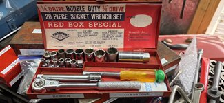

Spent a minute or two looking through this thread, trying to figure out what I had picked up today
.....apparently it's a 1438RBS set.

Lemme see now.....1438RBS
So...1438 for 1/4" and 3/8"
RBS for Red Box Special

Don- do you think that not-red box is an Action? Gonna look in my shop later, believe I've got an action box that same color and set up the same as my Thorsen RBS...

Take a look at my completed set a few posts up from here. Lemme know which sockets you are missing as I probably have multiples and can help you get that box back to its original shape. I don't have an extra adapter but do on the sockets. I'll photo copy the insert that Don sent me onto hard stock and send ya that too. Just PM me...
16,751
I’m pretty sure that the paper red box label was put in that box at the factory. I strongly suspect that quality control slipped up on that set and somebody just grabbed the wrong box. Whether the box was intended for an Action set I don’t know.
Ha ha, new guy at the Thorsen factory assembly line. One day they ran out of red boxes and that guy needed to finish one more set to qualify for the "most boxes finished in a day prize". He walks over to the Action assembly line and snags a blue box...the rest is history!

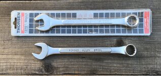

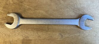

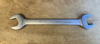

Here is a Thorsen raised panel combination wrench. The wrench itself isn’t marked with a COO. I guess Thorsen got around that by marking the packaging. IMG_1783.jpegIMG_1782.jpegIMG_7393.jpeg
Thorsen actually sold a few raised panel combination wrenches in the US but they are clearly marked with the COO.IMG_0128.jpegIMG_5224.jpegIMG_0127.jpegIMG_2397.jpegIMG_2396.jpeg
