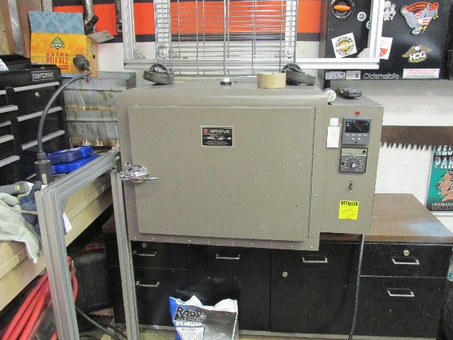

check out some auctions sites that cater to used industrial equipment. got a good deal on this one.
